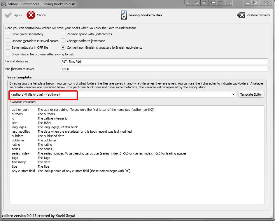

STD - see attachment (Preferences->Save to Disk)
