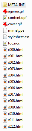

@Agama: Where can we find your plugin?
It's not online anywhere because it's probably too specific to my own workflow with Markdown sources.
As well as the features I've already alluded to it does a few other things: (1) All the _split_nnn.html files get renamed; (2) an externally prepared cover image and logo are copied into the book; (3) page_styles.css is removed from the xhtml files and an externally prepared stylesheet.css is copied into the book; (4) the long string IDs in toc.ncx are replaced with simple IDs of "P" followed by the playorder number; (5) in the xhtml files it replaces "Unknown" in <title>Unknown</title> with the actual book title.
Attached image shows list of files in a typical ePub after processing.
