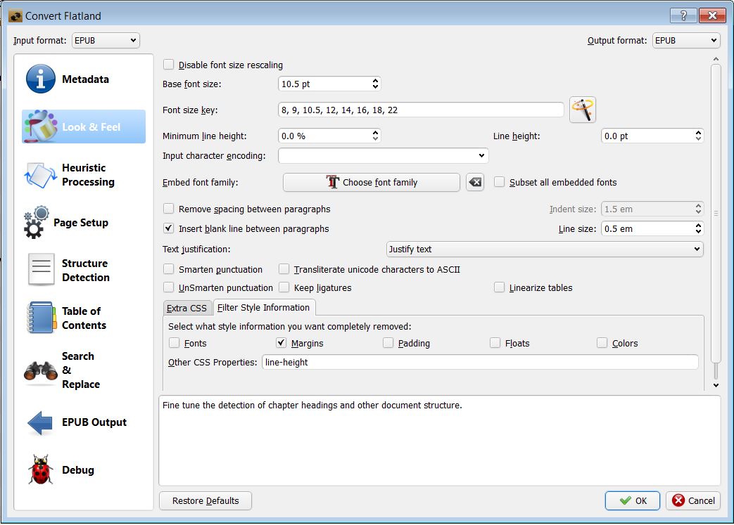

Maybe try the "Filter Style Information" on the "Look and feel" window?

@ JohnF,
Whilst your suggestion should work, it's a bit extreme (IMHO) to cure the left/right margin slider problem, as it will obliterate all margins inside the epub which could ruin the styling of many epubs.

I don't seem to have problems with the margins or fonts on my glo. I leave "Disable font size rescaling" un-checked (which is contrary to advice I've read elsewhere ). In the "Extra CSS" tab I have "body {orphans: 0; widows: 0}"
and in the "Filter Style Information" tab I check the first three toggle boxes. "Fonts", "Margins" and "Padding".
Hope this helps, I don't know where I picked up the settings (probably the Calibre forum) but they work for me. I mostly convert Mobi's to E-Pub though, not sure whether that makes a difference.
Just for clarity, with these settings I can adjust the margins on all my side-loaded e-pubs
