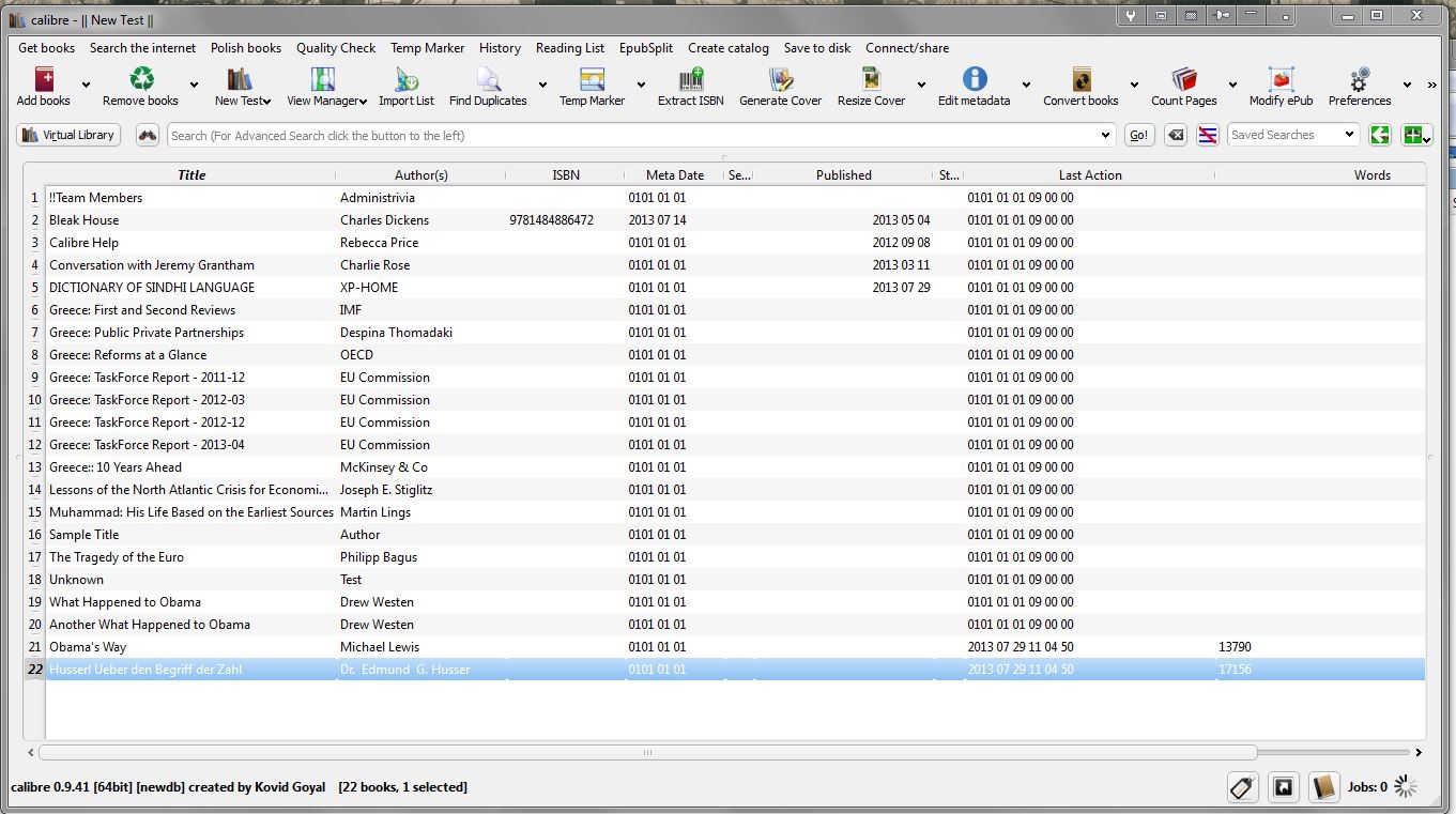

Date Display in Spreadsheet & Find Duplicates
On Windows 7 SP 1 calibre, version 0.9.41 64 bit
Start Calibre - seems to be snappier when it gets to the screen display steps, I see three transitions. Not noticeably faster in getting to that stage. But Calibre start times have never been an issue for me - anything that starts faster than firefox is a bonus
Problems
1. Custom Dates that were Undefined are displayed in their spreadsheet cells as "0101 01 01 09 00 00", previously they displayed an empty cell. Format for these dates is "yyyy MM dd hh mm ss"
2. Find Duplicates
Right arrow ALWAYS throws this error (not a crash)
ERROR: Unhandled exception: <b>AttributeError</b>:'FindDuplicatesAction' object has no attribute 'duplicate_finder'
  File "calibre_plugins.find_duplicates.action", line 200, in show_next_result
AttributeError: 'FindDuplicatesAction' object has no attribute 'duplicate_finder'

Old 07-28-2013, 10:04 PM   #26
Posts: 22,881
Karma: 34252744
Right or Left arrow in Library view works without fuss , even at the ends where it just stops (as it is supposed to do)
A unassigned date mm/dd/yyyy in a custom column is just blank
What's Library View ?
See attachments for what i see in Undefined custom dates with olddb and newdb, Meta Date and Last Action Date are custom columns - Publisher Date, a factory column, is OK.
The Find Dup error on right arrow seems intermittent. I've seen the error when I switch physical and virtual libraries and Right Arrow will be OK. But once I get the error with Right Arrow then I get it for all subsequent Right Arrow presses until I do a restart.
I can induce the Right Arrow Problem by doing the following
Select book at top of spreadsheet
Sort spreadsheet on a column that will throw selected book down the list so its not in first page of list,
Ctrl/Home, Right Arrow
With the olddb Ctrl/Home, Right Arrow will make cell 1:1 current
With the newdb it will throw the Find Dup error, as will all subsequent Right Arrows.

Name:	Capture olddb.JPG
ID:	108694   Click image for larger version
Name:	Capture newdb.JPG

Library view is what you show. (other views are Book Details and Metadata Edit)
I have a custom column: Edit EPUB(#edited), Aligned Left
All dates look normal .
Have you tried to change the date display format?

Just changed over to test the Kobo related stuff.
The first thing I noticed was that my custom date column shows "01 Jan 0101" if the date hasn't been set.
Then when I tried to change libraries, it crashed with the Windows "calibre.exe has stopped working". It started with the other library OK, so I did a check library and had the same error. I didn't have a device connected at the time.
I tried both when running from source with the same results. No messages went to the console. I updated the source around the time you release 0.9.41.

@davidfor: Send me the metadata.db file from the calibre library for which you get a crash.

@kovid: As far as I can tell, it's all of them. I went back to the old db backend and checked, they all seem OK there. I also ran an SQLite integrity check with no errors. Other than changing library or the check library, everything seems OK.
I have just put a database at http://www.alpha.net.au/~dforrester/metadata.db.
