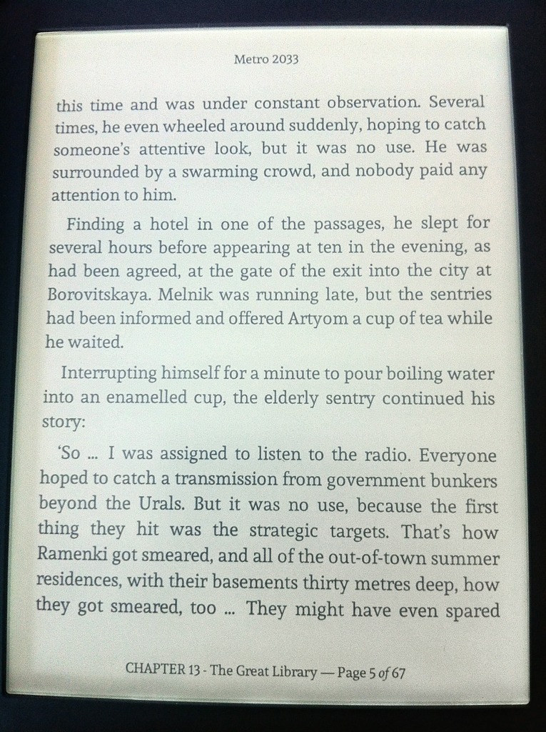

I've been using Andada lately, which I'm really liking. Could be a hair thicker, but overall it's very readable while maintaining character.
