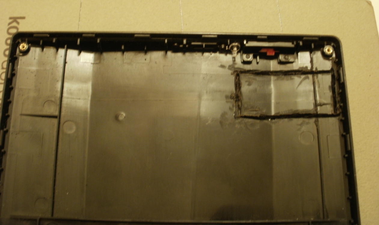

Here are some pictures of a hatch I made that allows access to the internal uSD card of my AuraHD. It is made easy by the adhesive backed foam rubber cussion/gripping surface I applied, see post: https://www.mobileread.com/forums/sho...d.php?t=214575

I am interested to learn more on how to open up the AuraHD, mind taking abit more photos and some walk thru for case opening?
Thanks.
The case opening process is very simple. The case is made out of two basic parts, the case itself and a Bezel that snaps onto the case. The Bezel has little slots in it that slip over bumps on the inside of the case. (You can see the bumps in the first picture above that shows the inside of the case, with the electronics removed.)
The opening process is a matter of using something of about the thickness and rigidness of your thumbnail, to separate the slots and bumps. You just have to work it into the crack between the Bezel and the case and then work your way around the case slowly lifting the Bezel as you go to both move the slots away from the bumps and lift the two sided tape that is on the Bezel off the screen.
