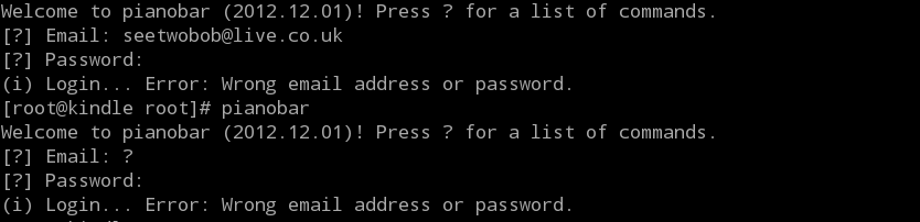

Yeah okay I got it running.
The only tricky bit was http://packages.debian.org/sid/armel...on-c2/download
which needs renaming to "libjson.so.0" as the dynamic link won't place on FAT.
(The link is in libjson0_0.11-2_armel.deb, that won't work)
one more point...
I have no idea what this is for.
radio I think?
I have no account or anything so I couldn't login.
Enjoy.
you will need to setup your LD_LIBRARY_PATH and PATH variables obviously to point to wherever you dump this stuff.
All I have included here is the relevant stuff ripped straight out of debian.
if you are missing a lib just search for it's name and "armel" on google.
Worked okay on mine.

so yeah.
no go for me.
