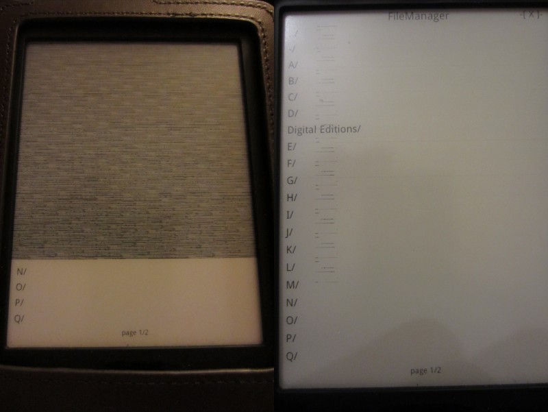

Originally Posted by WS64 View Post
Tested the 2.6.1 version on my Mini.
Now it starts, but after that I get the same result as ewphoenix123 in post 22, so I don't think it is related to the screen resolution.
Looks like this (looks different every time), 2 examples:
Attachment 107557
(Click to enlarge)
Ihave the same problem on Glo with 2.6.1, using KoboLauncher to run Koreader.
If I understood, it's a problem of Koreader when laucher by KoboLauncher.
It's correct?

Basically, it's a problem of KoboLauncher :P I don't know how it paints the screen but it seems uncorrect since it keeps using it even when it's not doing anything. For the time being (at least until someone ports Tweaks) you have to sacrifice the other programs and place the command to open koreader in KoboLauncher's shell script, so that it does not open its app.

Maybe someone can create a new PNG file for KOReader and edit the Kobo Launcher installation file so the new PNG points directly to KOReader...
It doesn't paint Qt does If reboot is only way to exit koreader, killing KoboLauncher like you do with nickel is ok.
