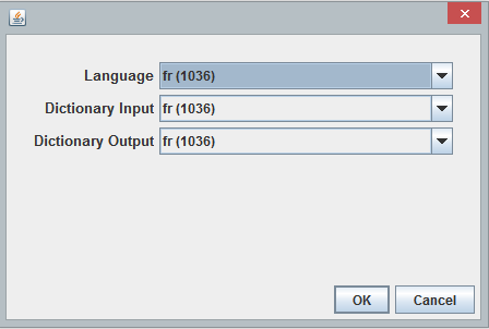

Note that dictionaries have 3 language metadata entries (document language, input language and output language). Unfortunately, only the document language, which has no effect on dictionary selection, is shown in Calibre.
AFAIK, only Java Mobi Metadata Editor displays all of these metadata entries. (For example, in the French dictionary that you have all of these entries are coincidentally set to French.)
Note that unless a default dictionary has been defined, the K3.4 firmware will always select a dictionary based on the dictionary input language of the dictionary. I.e. changing the document language of a mobi dictionary file is rather pointless.
I have multiple custom dictionaries installed on my K3.4 and all of them are correctly selected if the document language matches the dictionary input language language.

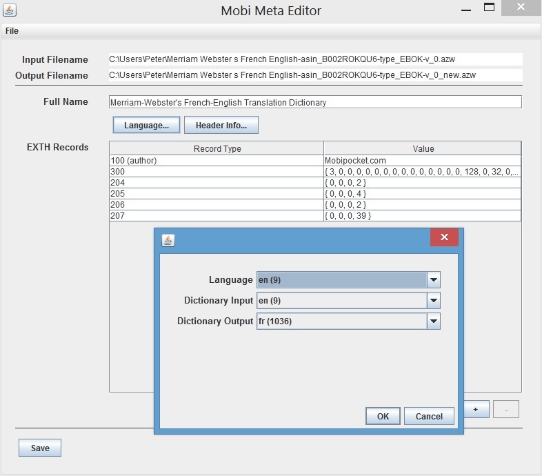

Thanks for the link to JavaMobi Metadata Editor. Mobi2Mobi does show three entries, but one of these is sometimes wrong.
The input and output languages are indeed correct for the MobiPocket 1932-35 Academie Francaise dictionary.
However the problem with the Merriam Webster French-English and Spanish-English translation dictionaries is that the input and output languages are reversed, as shown in the attached image. These input and output languages are the same as the corresponding English-French and English-Spanish dictionaries, and so correct in the English-* dictionaries but wrong for the *-English ones.
I can use the editor to correct these settings, but the corrected file is then not recognised when uploaded to the Kindle. I guess that this is because the file is protected against tampering by a CRC calculation.

I have now been able to switch the input and output languages for both the Spanish-English and French-English Merriam Webster dictionaries, and both now work correctly. When I tried to do this on PC and then upload to Kindle, either by USB connection or using Send To Kindle, this failed. But when I used MobiMetaEditor to edit the azw files already installed on the Kindle, then deleted the originals leaving just the edited copies with input and output languages switched, this worked.
Worked immediately for Spanish, but I had first to set the French dictionary as default, allow it look up a translation, then reset an Oxford English dictionary as default, leaving the French dictionary to activate automatically for French text, which it now does. I suspect that I may have set the French directory as default and forgotten that when I edited and then deleted the original, causing temporary confusion.
