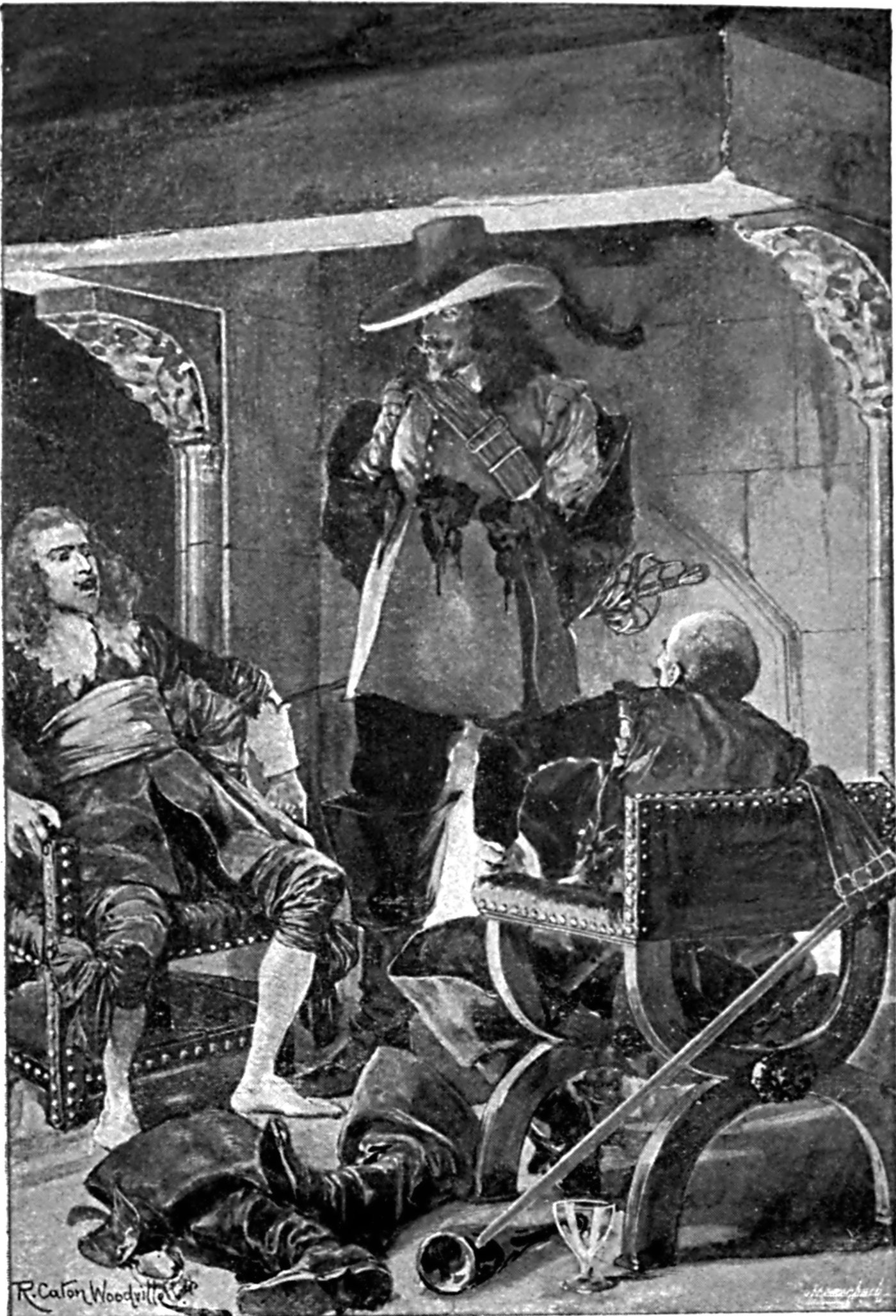

Advice on images please
I'm sorry if this is in the wrong forum for this post, and to have to expose my abysmal ignorance about images.
The attached image is from a book published in 1894, taken from the Internet Archive. I'd very much like to use this and ten similar quality images as illustrations in an ebook I'm proof reading now.
My questions in decreasing order of importance are:
- Is the image fixable - can it be improved enough to make it usable?
- How would you describe what is wrong with the image? What needs to be fixed?
- What software would you recommend? - preferably free. I have PMView, Paint, Irfanview, and GIMP 2.8. But I am starting from scratch so far as doing more than sizing and cropping, which is part of my reason for asking what is wrong with the image.

I don't see actually a lot wrong there. It seems like a grayscale image (although heavy on the black) of a painting. Perhaps a small 'cartoon' filter used additionally.
Perhaps you can find a better image of the original painting? It looks a bit familiar.

It looks like a bit like it has had a blur/despeckle filter applied, but it might simply be old printing technology.
As for advice, I'd fetch the "original", which in the Internet Archive means clicking on "All files", and then choosing one of the largest files, probably one with "jp2" or "raw" in its name. If the image can be improved, it will be from there.

I don't think there's much to be fixed as it is...

Did you remake this image? It has too few shades of gray. The post internally has plenty of gray shades but the source must not have.

Yes, I did. I thought it might help to get the pdf and do a snip of the image with the Windows Snipping Tool.
Since Jelby's post yesterday I went back to the Internet Archive. Although I couldn't find a 'Raw' set of files anywhere I did find another version, downloaded the ePub file, and unzipped it to get at the images it contained. Most of the images seem better, but I've attached another image
which seems even worse. The scene is in an inn at night, and to my untutored eye looks awful. I know it doesn't look good, but don't know how to fix it.
I've seen and happily used other images I got from Internet Archive ePub files for other MR ebooks, but they looked a lot better than these.

hi Alex. I took a quick look at archive.org, they have quite a few editions of Under the Red Robe. From just a fast glance, it looks like *maybe* the images in the archive http://archive.org/details/underredrobe00weymiala *might* be the best quality you will get (though they still are not excellent, reproduction methods were not the best back then for paintings and photos).
To get the scanned pages -- on the "download" page for each archive, under the list of formats offered, is a link for "https". This will take you to the FTP page, and you will find a list of files. Look for the ones that end in jp2_.zip, or jpg_zip. The image zip files are quite large, and sometimes very slow to download (often 20 - 45 minutes!)
Use the "read online" feature to view the book, and download the ones that look best to your eyes. Then the only thing you can do is open the zips and take a look at the actual scans and pick the best ones. Sometimes, it is better to use individual pages from several different archives (when available).
The actual physical cleanup and re-sizing depends on the image editor you decide to use. As you know, I use PaintShop Pro, and not too many folks do. Lots of people use the GIMP for free, or Photoshop (pricey!). There are lots of freeware image editors out there, many very highly rated, such as PaintDotNet.
In general, you usually need to either completely desaturate the image or convert it to grayscale. Then maybe adjust the contrast, then clean up scratches and spots, and downsize the image. Keep the image in a lossless format, such as bitmap or (photoshop) psd, until the very end, even though the file size will be very large. Jpeg is lossy, and you will lose quality every time you re-save the file.
(I haven't forgotten, I'm still plugging away at Innocents, but not much free time these weeks)
EDITED TO ADD -- PS --The image you posted is pretty bad, though I have worked with worse. The only fix for something like that is to literally restore it using clone brush and smudging, and dodge and burn (yep, like developing photos). Sometimes you can't tell if the flaws are due to dirt and damage, to scanning artifacts, or if the artist actually drew it that way, very frustrating. It takes a lot of patience and sometimes the end result just isn't worth the time and effort.
The attached samples from a book I worked on once show a fair amount of improvement, I think, but I don't know if it was worth it. But at least now the man in the corner actually has a face.

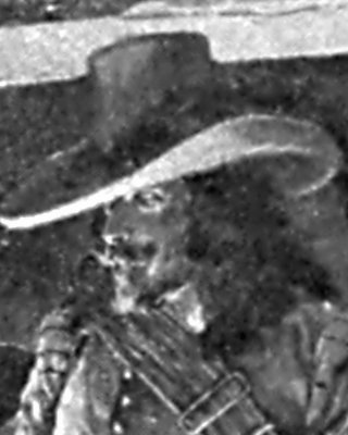

  • Observe that in this case there are dots (rasterization?) in the image. They mess up image sharpening, we remove them by 'Filters->Blur->Gaussian Blur' ,blur radius 2x2 pixels.

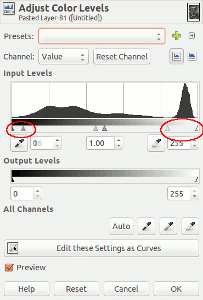

  • Select 'Colors->Levels'
  • In the Popup window, slide the white triangle below the histogram to the left until the paper margin in the picture is white, i.e. to the left of the right-hand peak in the histogram.
  • Slide the black & mid-level triangles until you are satisfied with the result, and click OK.
  • Select 'Filters->Enhance->Unsharp Mask'. This filter accentuates borders between dark and light areas, so it actually sharpens the image.
  • Use default values (5.0, 0.5, 0)
  • Undo & fiddle with values if result is unsatisfactory, or just skip the unsharp filter.
  • If you have wavelets installed in GIMP, you can use it to mitigate the effects of unsharp again When the image is a bit 'blobby', as in this case, wavelets can smooth things a bit. Apply 'Filters->Enhance->Wavelet denoise', in this case Threshold=0.75, Smoothness=0 are sensible values.
