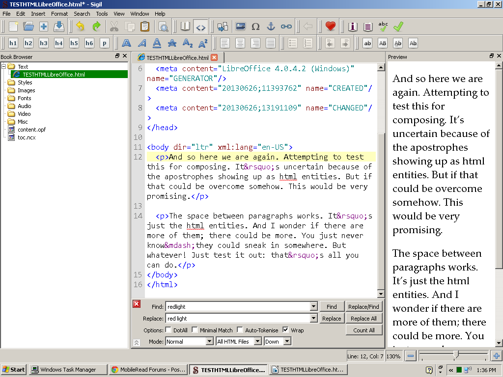

can sigil convert html entities to regular punctuation?
I've been looking for an easy way to compose a novel and then seamlessly transfer it to Sigil for the end processing. The best thing I've come up so far is Libre Office (File-->New-->HTML document) and then taking the .html to Sigil. But in Sigil a lot of the punctuation marks show up as html entities. (Which is difficult for me to deal with.) Is there any way that once I'm in Sigil I can convert those html entities (see screenshot) back into regular punctuation marks? Thanks.

Not that I know of. Sometimes you can see them as characters (I believe when you edit in Bookview), but it gets transferred back to entities later.
I actually like that, it makes a lot of things easier to see, but I can imagine that is not for everyone.

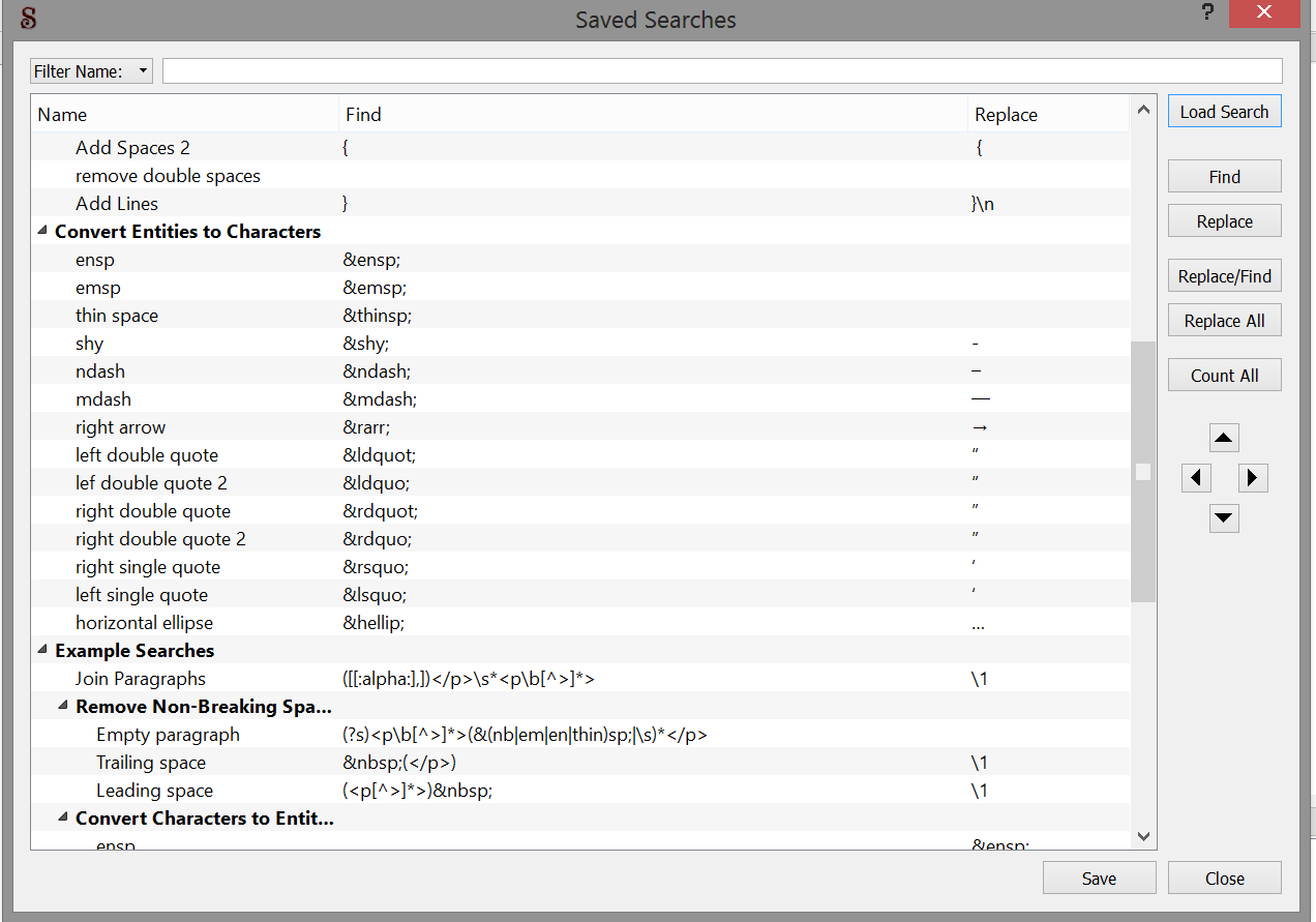

In code view you can do a search and replace.

Might be a little tedious to set up, but you could add more 'Saved Searches' with the entities that you find you need to replace often.
Sigil comes with a number already built in
You'd also have to run a possibly large number of Saved Searches one at a time, but it's still easier than manually changing them
Paul
Paul
Sigil does come with a bunch of them saved...you can definitely add more like I did:
You can also run the entire group of Searches by selecting the group name and then "Replace All".
Cheers!

I was wondering why you said I'd need to replace "often" and run "a possibly large number" of saved searches. Wouldn't it be just a one time deal? Open the html doc in Sigil. Run the saved search. Then all is changed over. Right?
I can certainly use the entities, but it is much more natural to use the actual character. My brain doesn't have to do the interpretation, and I'm all about doing things the lazy...errr...I mean...efficient way!
The saved search I have is just a click away and it transforms all of the entities. That....efficient...use of time is something I am willing to do!
I think I'm going to have to get more familiar with saved searches, Turtle. I never used them before. (It seems like a pretty painless solution. Better than starting with a MS Word doc and having to clean up all that crap.)
