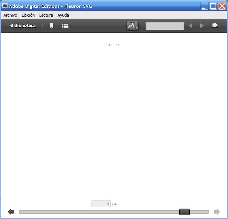

I’m trying to adapt my suggestion above to SVG images—which it should be possible to make hr tags appear with, right?
<?xml version="1.0" encoding="utf-8" standalone="no"?>
<!DOCTYPE svg PUBLIC "-//W3C//DTD SVG 1.1//EN"
  "http://www.w3.org/Graphics/SVG/1.1/DTD/svg11.dtd">
<svg width="60" height="10" xmlns="http://www.w3.org/2000/svg">
  <text stroke-width="0" x="30" y="7.3" font-size="10"
        text-anchor="middle">—»·›–•–‹·«—</text>
</svg>
Can’t figure out the CSS to make this work, though. This isn’t working:
hr { background-image:url("../Images/hr.svg"); }
jcsalomon is offline   Reply With Quote
Old 06-29-2013, 08:53 AM   #14
SBT
SBT's Avatar
Posts: 580
Karma: 810184
Location: Norway
Background images not supported in epub2 specs, I'm afraid
Old 06-29-2013, 11:22 AM   #15
RbnJrg
Posts: 1,938
Karma: 9699999
Join Date: Mar 2013
Device: Kindle 4 NT
</svg>
With the tag <hr> doesn't work. Try the following:
In you .css stylesheet, write:
.svg_fleuron {
   background-image: url("../Images/hr.svg");
   background-position: 50% 0%;
   background-repeat: no-repeat;
Write it as I did it; don't use the background shorthand property.
In your .xhtml file write:
<p class="svg_fleuron">&nbsp;</p>
It should work.
Regards
Rubén
