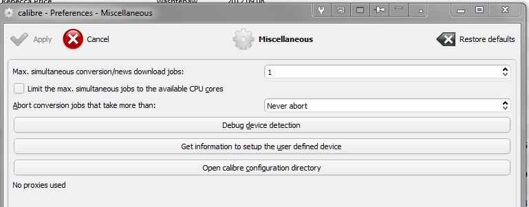

This is just a hunch. When I first started using calibre I had some issues with conversions gobbling up my system - I've found that the following settings get the work done and calibre doesn't impact other things - I'm running windows 7 on a 6G I5 with a wd spinning disk drives.
Preferences->Behavior->Job Priority = Low
Preferences Miscellaneous-> see attachment
