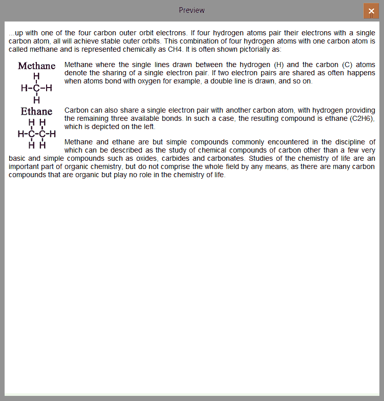

I put the code I gave you...with minor modification (below)... into sigil and came up with the following for Sigil and ADE...seemed to work fine. I've also attached the actual test epub if that helps.
CSS:
div.FrameSmall {clear:left; width:100%}
div.Float-L {float:left; margin:0 15px}
p {text-align:justify; margin:0 0 .5em; text-indent:0}
HTML:
<body>
  <p>...and is represented chemically as CH4. It is often shown pictorially as:</p>
  <div class="FrameSmall">
    <div class="Float-L"><img alt="" src="../Images/Methane15-1.png" /></div>
    <p class="First6">Methane where the single lines drawn between the hydrogen (H) and the carbon (C) atoms denote the sharing of a single electron pair. If two electron pairs are shared as often happens when atoms bond with oxygen for example, a double line is drawn, and so on.</p>
  </div>
    <div class="Float-L"><img alt="" src="../Images/Ethane15-2.png" /></div>
    <p class="First6">Carbon can also share a single electron pair with another carbon atom, with hydrogen providing the remaining three available bonds. In such a case, the resulting compound is ethane (C2H6), which is depicted on the left.</p>
  </div>
    <p>Methane and ethane are but simple compounds ...</p>
</body>
edit: oops...I added an extra "Methane" to the paragraph next to the methane pic.

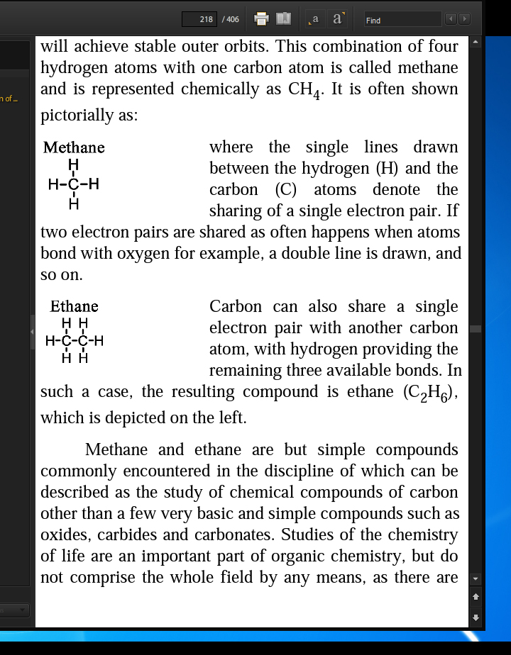

Hi Turtle:
You're right, I had a margin left over from the code's previous iteration.
Getting closer (see jpeg). But the margin is still large. Maybe that's as good as it will get?
Michelle

Ahhh...you've left width="40%" in your <img> tag...that is taking up 40% of your div container even though the picture is much smaller.
Take it out completely like I did - or - set a max-width:Xpx (where X is the largest number of pixels you want it to take up)...I think those images were about 80px wide IIRC.
Cheers,

Hi Turtle:
I think I see the problem. In your successful case, you made the image smaller and set it to a fixed size; I'm trying to set it to a percentage so it will enlarge with the user's screen. Perhaps, then, what I have is the closest I'll get if I want to keep the percentage option?
Thanks for all your help. You've been wonderful.

Turtle:
Alas, not working. The image class that specifies an em value for the image isn't being recognized by ADE, so the full size of the image is being displayed. Is that HTML5? ADE doesn't read HTML5 even though some readers will.
And if I try to add the em value div along with the percentage value so the image will scale, the image class is ignored.
(BTW, the p class is important, otherwise the em value for the text is ignored and screwed up in relation to the rest of the book.)
Here's my tests:

Okay. We're almost there. I have lowered the margin value of the Float-L division from 15px to 10px and that has gotten rid of the large gap between image and text. The em value is now recognized by ADE (and I also tested in Aldiko, which I have side-loaded on my Fire). Only one small obstacle remains: distortion of the image ratio. I added width=auto into the CSS, and while that works at most image sizes, there is some distortion remaining. Perhaps I suck that one up. But is there a better code than "width=auto".
So now it looks like this and it is working, save for the above notations:
