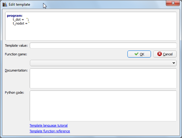

Old 06-04-2013, 01:54 AM   #12
darkul
darkul began at the beginning.
Posts: 7
Join Date: Sep 2011
It's your template, just with t_nodot replaced.
Even used an empty string there.
Tried this
program:
	t_dot = '';
	t_nodot = ''
and it stops with a syntax error on "program:"
Could it be that I have to install calibre from scratch, deleting every single trace it left anywhere on my machine? I try that first before we have to think too much.
-> Ok, done that ... same problem as before
darkul is offline   Reply With Quote
Old 06-04-2013, 04:27 AM   #13
chaley
Posts: 12,529
Karma: 8125420
Location: Notts, England
Tried this
program:
	t_dot = '';
	t_nodot = ''
That text works fine for me, as shown in the attached screen capture. Where exactly are you putting it when you get the syntax error?
