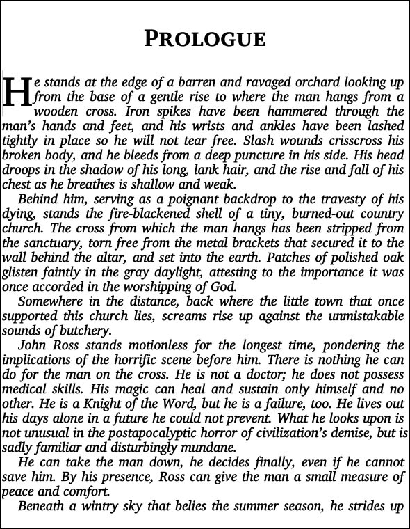

Posts: 84,134
Karma: 153695583
Originally Posted by William Ockham View Post
It is not possible to "change the amount of space between the lines" by altering any of the font metrics.
Yes you can. I've done it. Take a look at the two attached images. Both are the same font with the only difference being the metrics that I've edited.
So what would you call the fact that one has a grater space between the lines the other and all that was changed was some of the font metrics?
ID:	106057   Click image for larger version

JSWolf, what font metrics did change to achieve that effect? I will happily admit that I'm wrong if you can send me a font that behaves this way.
William Ockham is offline   Reply With Quote
Old 05-20-2013, 04:51 PM   #84
Posts: 84,134
Karma: 153695583
I changed Typo Line Gap and Line Gap. The original value was 0 for the first image and I changed it to 200 for the second image. These value work for ADE.
For KF8 I changed Typo Ascender/Typo Descender, Win Ascent/Win Descent, and Ascender/Descender.
All it takes is some experimenting to get the values you want so you don't have to use line height in CSS. It also makes KF8 usable as the line height displayed won't be too large.
Take a look at my modified Charis SIL versions. They have two different line heights when used on a Kindle with KF8.
https://www.mobileread.com/forums/sho...d.php?t=184056
