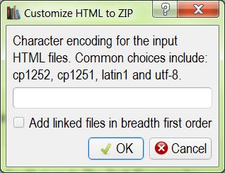

Originally Posted by Skydog View Post
Third time is the charm! I once again copied the original and did nothing but apply the modify epub (utf-8 encoding), as jackie_w suggested. It worked!! Thank you, jackie_w. In this case, it accomplished the shortcut to Jon's suggestion.
I'm glad you got it sorted out.
For future reference. If you were adding the original ebook to calibre as a html file then the coding was screwed up on adding the file. In which case the code needs to be fixed in the html prior to adding or the code set in Preferences - Plugins - File type plugins - HTML to ZIP plugin as explained here in section 2 (see attached.)
Name:	customize HTML to ZIP.jpg
Old 05-28-2013, 10:12 PM   #17
Skydog
Skydog's Avatar
Posts: 2,294
Karma: 7409537
Thank you, Walt -- that's very helpful when working with an html file. Apparently it was screwed up in the original (epub)but I am not knowledgeable enough to know what is wrong/missing simply by looking at the CSS.
