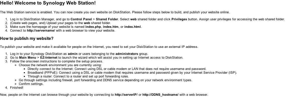

Did you edit or change the .htaccess file? If so temporarily rename it to something like htaccess.tmp. And try again.
If this did not help:
If you use your browser and type:
http://<IP_of_your_Synology>
do you get? (See thumbnail)
Name:	Screen shot 2013-05-27 at 5.36.25 PM.png

I never got that thumbnail you posted when I put in the IP or domain name. At first, if I typed in my IP or domain name, it would just default over to port 5000 and load up the Diskstation Management interface login. I looked at some other instructions on the Synology website and made a couple test files, an index.html and a phpinfo.php, and put those in the /web directory and so now it loads the test index.html I made when I put in the IP. It also loads the phpinfo.php and displays a whole bunch of information I don't understand when I put in http://[IP]/phpinfo.php.
I did not do anything to the .htaccess file. It is in the /Calibre directory. Is that where it belongs?
