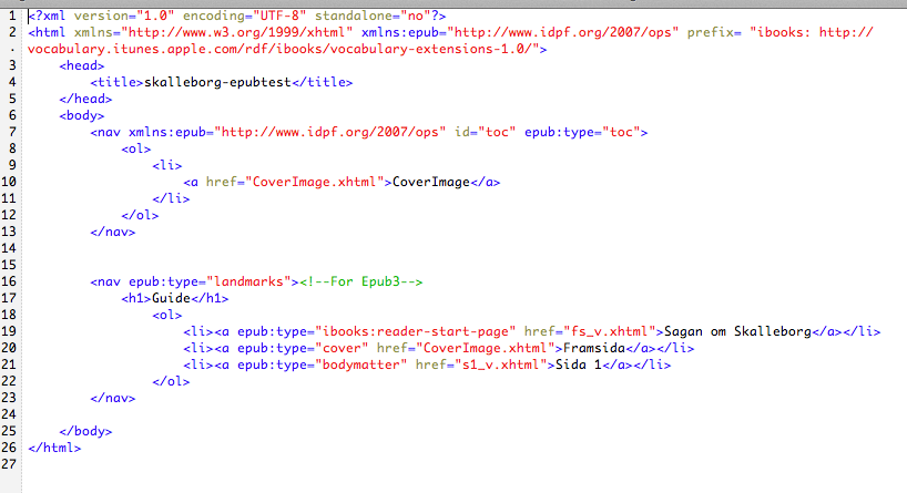

The ibooks:reader-start-page that some people suggest you can add to the landmarks section (to get the book to open there) still doesn't work. It is a declaration issue. Just putting it in gives the error Undeclared prefix: ibooks. I try to declare it in the html tag with:
prefix= "ibooks: http://vocabulary.itunes.apple.com/rdf/ibooks/vocabulary-extensions-1.0/"
...just like I did in the package tag in opf file without issues. But then the error is in the toc.xhtml - epubcheck says element "prefix" not allowed here.
I have added a screenshot of my toc.xhtml file with the prefix element added, if you can see anything wrong with it. (I have only one list item in the first nav list since I wanted ibooks to only show the visual TOC)

I'm pretty sure 'prefix' is not a legal attribute for the html element, which is what the error is telling you.
Have you tried using a xml namespace declaration instead?
ie xmlns:ibooks ="http://vocabulary........"

But, after studying the error and all the attributes that the epubcheck expected instead of "prefix", I did find one named "epub:prefix". So epub:prefix="ibooks: http://vocabulary....." did solve the error and there are no more issues in epubcheck.
I did not work anyway with the "ibooks:reader-start-page", it still opens up to the front page. So I guess that is a bit of a lost case.
