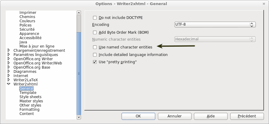

On writer2xhtml options, there is a mysterious line -for me- about named entities. Do you think it could be good to tick it? (see arrow on screenshot).
You can try it, but at least when I tested it did not help, even though it seems like it should.

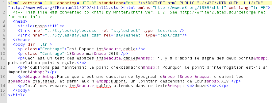

Outputting odt with named entities
I tried to convert my odt file using named entities. My converter (writer2xhtml) allows me to do that. Now Sigil 0.7.2 is very happy and display the real   that he finds immediately on the EPUB. However, there is a drawback...
é is now &eacute
French quotes become &laquo and &raquo
and so on....
See screenshot.
The text in Book-view is fine, but in Code view, it's very difficult to read and furthermore these entities fool totally the spellchecker.
So, the advised medecine seems to be worse than the illness. We cannot honestly recommend to output odt using named entities, because of these kind of problems, at least in French where we have lots of accents.

I would definetly use that option. Officially in ePUB3 named entities are no longer supported, but that is a long way still. Even so, look at other deprecated options in HTML, they almost all still work.
It would at least be a lot easier to see if the nbsp will be in the source then.

As a workaround you can use the writer2xhtml option so that named entities are used, and then you can create a Save Search group to replace each named entity with the actual character (e.g. replace &eactute; with é). Not ideal, but until there is a fix it seems the best option.
The   entity will always show up in Code View, even if this issue is fixed. This is because if the nbsp character is used, the Qt based Book View would incorrectly convert it to a normal space.
