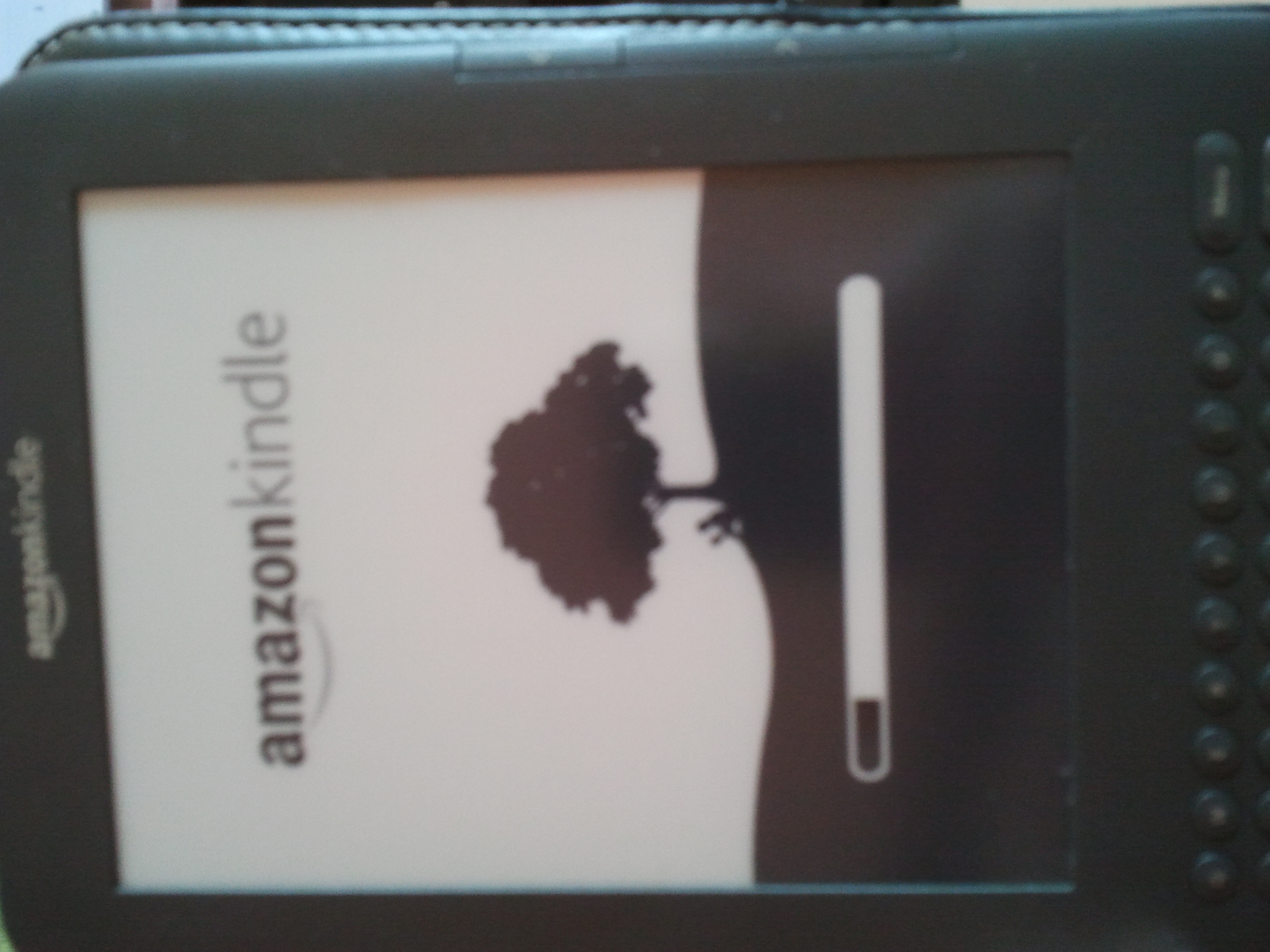

Hello,
First, I would like to say that the kindle debrick tools works
It's indeed a very useful tool.
But I have a kindle that I cannot debrick, I've tried several methods.
Here's the story:
My uncle wanted to update duokan on it, the update went wrong, and after reboot, the kindle stuck with the loading screen at ~20% (shown in the screenshot).Then he entered the debug menu, and pressed I, i guess (the option that formats all partitions). Then the kindle didn't boot not even at this point.
This is when he gave it to me
I've copied the firmware from another identical kindle, and with k3flasher, i've reflashed everything: kernel, devid, varfs, isis, partition3, basically all that was backed up with k3flasher.
Now the kindle got back to the original state, it booted at the same point as before.
Meanwhile I broke the cable connecting the display, so I had to order another one, therefore this project was dead for 1/2 year.
Today, I've charged the kindle (the battery was removed not to be drained) and tried to debrick with Kubrick.
The flashing completed successfully, it boots up (screen flashes, loading screen appears, but the progress bar stops again at 20%).
Right now I have no further idea what could have gone wrong.
Basically I've reflashed everything, but still doesn't boot.
I'm thinking to connect to the serial port, to check the kernel debug output. Maybe there i can do something.
But I need a 1.8V USB-Serial converter, which I have to order...
Any other ideas what I could do ?
Isn't there a way to write the kernel log to the SD partition to check it later (I can get to the debug menu, where I can mount the internal SD and it's visible from windows).
1) Which is where it typically stops when it checks if the battery's storage capacity is enough to run it.
Buy it a new battery. -- The step your Uncle missed.
(It wasn't "drained" but it certainly had aged before you got it.)
2) That would be a good idea, the kernel's ring buffer will have the battery info in it.
And anything else that might be blocking the boot-up process.
Also, there is a chance it is waiting for input on the serial port to confirm that it should continue the boot process under whatever condition it is finding.
3) In "Debug mode" on a K3 - you are running the Linux kernel with only different init scripting. (K3 does not have "main" and "debug" systems - just different init scripting).
One of the differences - -
It does not check the battery storage capacity nor set-up the battery management hardware the same.

Thanks for the fast answer!
At first I was also suspecting the battery. However, I've tried the battery in a different Kindle, where it booted without problems, and I was able to charge it with both the broken and the working one.
Note: When I've charged it with the broken one, after it was fully chaged, the yellow light changed to green. I've noticed that when there was no kernel running on it, the light stayed always yellow. As i've seen in some documentation, the kindle is able to charge the battery only if the kernel is running. Also, after a fully charge, the battery has 4.1V. So definitely it's not dying.
I suspect the same thing that you have pointed out: that the boot process somwhere is waiting for some input. However, I cannot find an 1.8V FTDI converted, only 3.3V.
That's why I was thinking that if I could export some debug info to the SDCard, maybe with some custom kernel, i could find out what's wrong.
The debug menu shows up, I can access the internal SD card, that means that the kernel did not panic, right ?
So it must be something with the startup scripts.
What is exactly rewritten when writing "partition3" and kernel ?
Aren't also the init scripts rewritten ?
Otherwise I cannot explain why it gets stuck also after flashing everything from a working kindle and later flashing with the live cd...

New battery also won't charge properly - orange light just goes off after variable period.
I'll look up the K3flasher prog.
PS K3Flasher seems to be only for Linux - I have XP....
Duh...
You also have Kubrick - which is a memory resident version of Linux.
It **can** be used from the command line.
It **probably does have** K3flasher already included.
