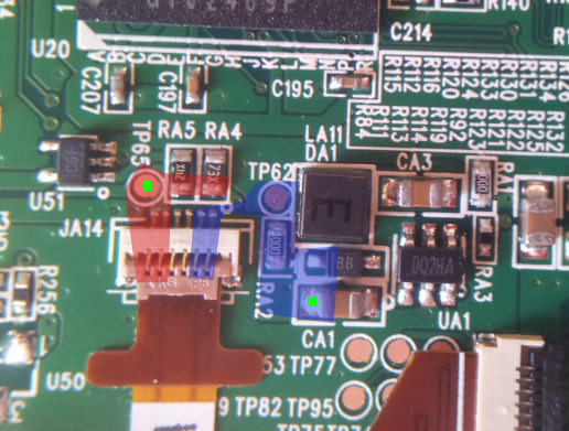

Originally Posted by akorx View Post
Is there another place where we can put a resistor that is more accessible and less risky (or an other electronic component) ?
And if it's possible, how many ohms ?
Just connect anything from the red area with the blue area via a 33k resistor.
If you want to use a bigger wired resistor, try the two green spots.

But just a question before, because I think you make a mistake : as you can see in blue there is a resistor ("000"), and what you are telling me is that "all the blue" is the same pin... so that means that this resitor is not used ... are you sure of it????
Thx Yoq for this, I will try...
Yes, it is a zero-ohm resistor, a bridge:
