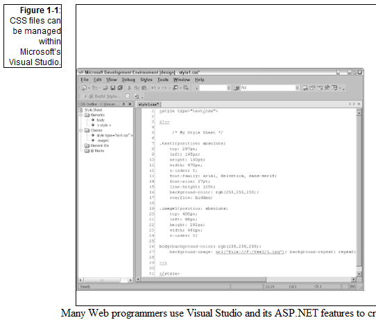

Hi there ladies and gents,
Have been doing a bit of work trying to learn how to create an ebook. Using a .pdf of one of my Dummies books and trying to make it look as close to the original as I can. Have searched far and wide to find an answer to this particular issue I'm having in trying to place the caption text in a div next to the actual graphic that the caption is for. Below is my html code...
<div>
    <div class="figuretext"><span style="font-family: 'Arial Bold'">Figure 1-1</span>: CSS files can be managed within Microsoft’s Visual Studio.
    </div>
    <div class="graphicbox">
      <p><img alt="" src="../Images/Figure01-01.png" /></p>
    </div>
    <div style="clear: both"></div>
  </div>
And this is the CSS code...
.graphicbox {
	float: right;
	margin-left: 13%;
	margin-top: 0em;
	border: 1px solid black;
.figuretext {
	float: left;
	font-family: 'Arial Regular';
	font-size: .75em;
	text-align: right;
	margin-right: 88%;
	margin-top: 4em;
From all the research I've done on this subject, the two div's should be happily coexisting side by side. The problem is they are not. I have floated a graphic to the left of a paragraph of text without issue, but as you can see from the temporary borders I have placed around the div's, the code is 'trying' to do the right thing, but somehow cannot. Anyone have a solution?
Last edited by BruceWDarby; 05-07-2013 at 08:47 AM. Reason: Edited to remove 'middle' from div float...

Check the float tag. there is no option for "middle", only left, right, none, or inherit.
W3Schools Float reference
Turtle,
Thanks for that. Was kinda wondering, but did find that reference on one of the CSS sites I visited and thought I'd give it a try. If my graphic is resized down to where it will only fill one-third of its div and floated to the right, the two div's are raised to the same level, but if I increase the size of the graphic to anything over 50% of the div, it drops under the div containing the caption. The same is true if I place the graphic above the caption in the html code. It acts as if the right margin for .figuretext is being ignored by Sigil and the graphic is being forced down as a result.
Thanks for the assist...

Found the answer. 'Twas the margins in the CSS class's. For some strange reason, Turtle, even though middle is not supported, it does work. Thanks for helping me over the hump.

I would check to make sure your ePub validates properly. If you have invalid CSS it might display properly in Sigil, but could totally barf on a different display like ADE.
Do not Depend on something that appears to work in Sigil
Sigil will tolerate more errors (IMHO allowing any non-spec feature is an error) than the Spec allows.
Then you still need to check your work on Devices because DEVICES do not always support all of the EPUB SPEC.
to wit a 50% <hr /> appears as intended in Sigil/ To get it to appear the same with ADE (MRSDK), you need to fake the center by using a margin-left: 25%
Do spend some time reading the stickies at the top of formats forums. It will save a lot of hair pulling/ later.
