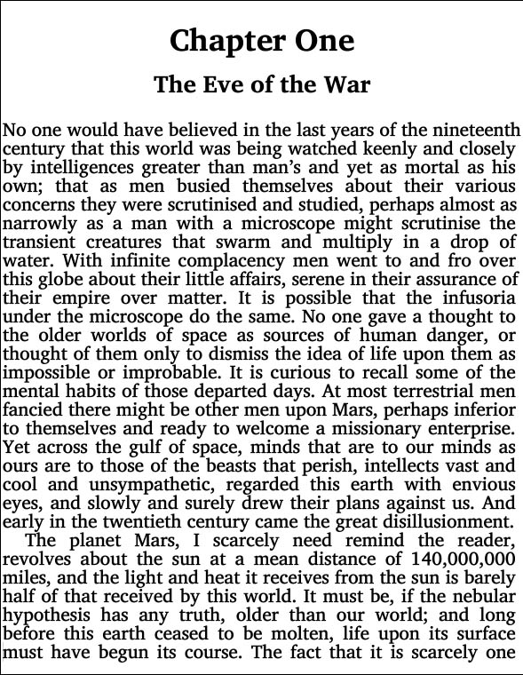

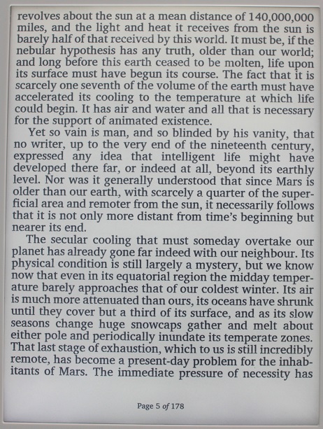

I would like to see a screen shot from this eBook so I can compare how it looks on my 650 in terms of how much text I get on screen. I've set specific values so I'll know for sure that the text will be the same size with the same line height.
Thanks.

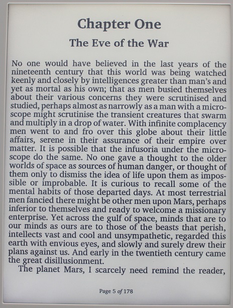

Thanks.
Here you go.

Just tried War of the Worlds on my Kobo Glo as well and it looks very different with a much smaller font size and the left and right margins are non existent with the text right up beside the edge of the screen.
Name:	War of the Worlds v4 on Kobo Glo.JPG

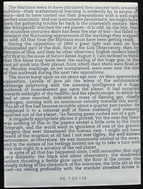

Thank you for that. Now to what's really odd. The Kobo screen has more space yet I get more text on my 650.

40 lines of text per page, and over 60 characters per line, on the Glo. That font must be really tiny The margins are so tight, that letters from two different lines are actually touching. This is nigh unreadable :X
I actually don't like the text to be THAT close to the side. It looks weird to me.
The font size on the Aura is way too big, that might be why, if you look at my screen shot from the kobo glo the font size is much smaller on the same file so something is not working right with the settings on v4 of your file I think, at least the Aura and glo are not interpreting those settings in the same way.
Edit: I just copied the files over using windows explorer to both the glo and Aura, did not use Calibre

Notice the screen capture of the Sony. You will see the space left between the end of the text and the end of the screen. What's not shown is the bottom line that shows the font size setting. page number, and the battery meter. That's at the very bottom of the screen and the text can go down to just above it.
On the Kobo, you have the white space above the page number and you have white space below.
On the Kobo photo with no chapter heading, that's 31 lines where on the Sony it's 36 lines.That's a lot of waste of screen space on the Kobo.

Is there anything that should have been done differently? I did expect to get more text on the Aura's screen. I set the font size in p to 1em and H2 to x-large and h3 to large. Line height is set to 1.0em in p, h2, and h3. So if I can fix things to get more text on the Aura screen, please tell me how and I'll make the changes in v5 and post that.
I don't know much of anything about CSS so I am not going to be of much help with this I am afraid but as I mentioned in another post I simply reduced the font size by 4 on the Aura and it looks very similar to your screen shot of the 650 but I get another 4 lines of text on the page over what you get on the 650.

Originally Posted by jiminrussell View Post
I would agree, I couldn't read it like that either, the text is too small and the lack of any margins at all on the sides makes it difficult to read on the glo.
Edit: I increased the margins by 1 and now it looks just fine with that font size on the glo.
I reduced the font size on the Aura by 4 and it looks much closer to the screen shot that JSWolf put in his post from the 650 and I get another 4 lines more of text than he has on the 650.
Can you please show that screen? Thanks.

Trying to compare number of lines on different readers seems to be very difficult as it isn't easy to get the font displaying the same, especially when using readers from different companies.
My suggestion is to compare the physical space available for text on the different readers. I recently did just that, see my post Aura vs Paperwhite for measurements taken on the Aura. However I no longer have a 650 so I can't provide these measurements. Then, assuming you would use the same (perceived) size font to read with, this should give a good idea as to how much more text you would see per page on the Aura.
