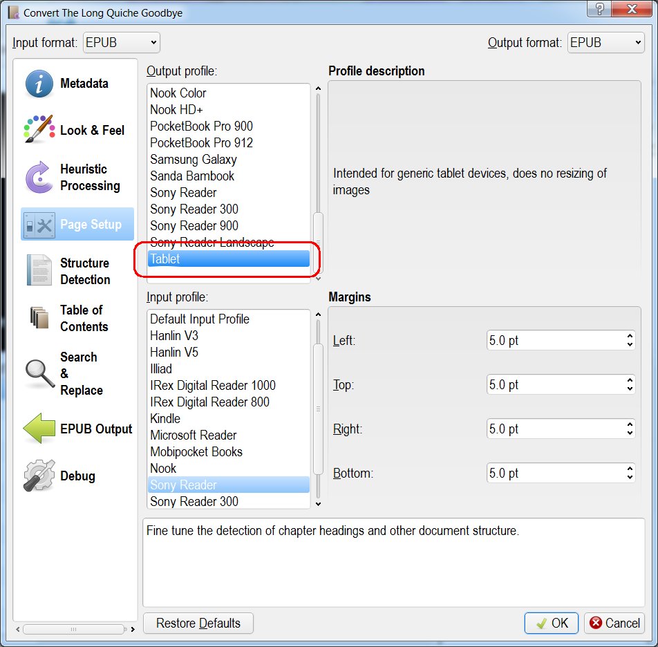

Originally Posted by gers1978 View Post
It also seems Calibre is DELETING images, not just optimising them. I'm sure there's a very good reason and I'm sure Kovid can explain it. Maybe Calibre can see that although they're inside the .mobi file, they actually aren't referenced anywhere in the HTML file, and are therefore pointless/surplus to requirements?
I believe setting the output profile (see attached) to tablet will prevent any resizing of images.

I tried the Tablet setting and it STILL comes out as 8MB!
Yeah because the MOBI output plugin resamples jpeg images, to ensure they work with older devices, that have limitations on maximum image size. That much should be obvious by just comparing the images in the unpacked mobi. Same resolution, smaller size => resampled image.
