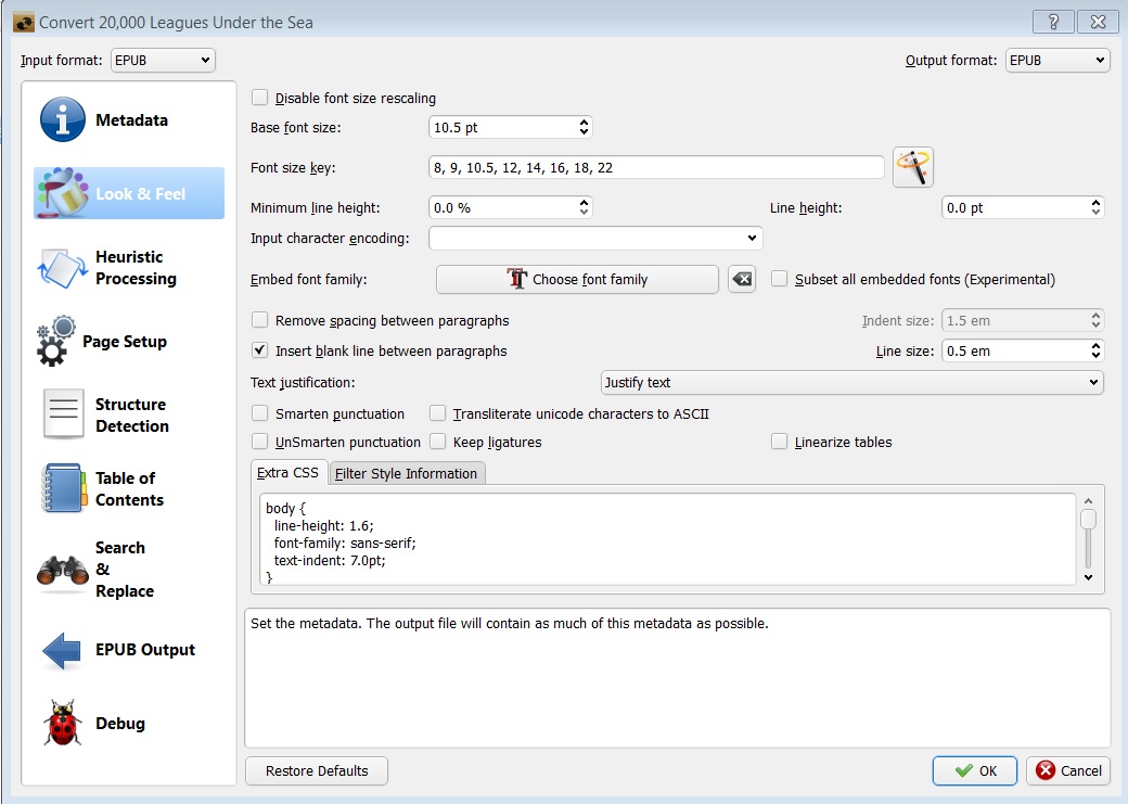

I got a little lost in the Kobo Rocks thread and the line spacing discussion, so I would like to know...
Can I use calibre to get tighter line spacing, and still fine tune the line spacing thru the Kobo GUI?
What would I need to set on the following screen.
Thanks.

Try setting minimum line height to 100% and see what happens.

Not absolutely certain but I think you need to attach the line spacing to a <p> or <div> or other lower level tag and not to the body tag. For an .epub file, the line-height in the body will have no effect. If you use the lower level tags, the Kobo UI will not let you modify the line spacing.

You could try in Calibre:
Convert books
Look & Feel
Filter Style Information
then in other CSS properties add line-height.

I do do that sometimes (it allows me to change the line spacing in the GUI), but it doesn't get me tighter line spacing.
Regards,
David
So your saying that i can have fixed tighter line spacing OR changing it through the GUI, but I can't have both?

You can force the Kobo to have tighter line spacing by editing the stylesheet.css file for the epub. 120% or 1.2em works well for me. Once it's within the epub though, the slider to adjust line spacing from the Kobo GUI has no effect, which isn't really a problem if you've set the css correctly to your liking.

I use Sigil to set the line-height in the stylesheet, usually on the p tag, e.g.,
p
    line-height: 1.2em;
If there is already a p tag in the stylesheet then you need to add it to that. You can also be more selective--perhaps you do not want to set the line-height for all paragraphs, but only for some styles?
Also, some epubs do not use p tags for paragraphs, they may use divs or spans. This is annoying, but with Sigil you can easily check for this.

You can try the code I posted above in the Calibre Extra CSS field, see if it works. It may not, especially if there is already a p tag in the stylesheet.

Correct. I use 1.1 in my stylesheet for body text and 1.2 for headings and other non-body text. I also tend to use one font for all my reading so I don't run into the different appearing line spacing with different fonts. Margins are also set in the stylesheet. the Kobo slider will let you increase the left/right margins if you wish to do so.

The line spacing slider doesn't work even if it can make changes as the minimum of 1.3 is too big to start with and can only get bigger from there.

Actually, do the following and it will work better overall...
 p, div, h1, h2 {
line-height 1.2em
Put that at the top of the CSS and if there are any other styles used that change the line-height, that will override your 1.2em and if not, your 1.2em will work as is for all those.
A span is not a paragraph level tag. So it doesn't need a line-height to change the Kobo default.
But if you want to make a temporary change to a bigger line spacing, you can't. Or if you are sharing the library with your family and they like different settings. When I fiddle with an epub, I like to remove as many of the hard-coded settings as possible. That gives the most flexibility when reading the book. For line spacing, Kobo's minimum of 1.3 is almost right for me. I'd probably use 1.2 if it was there, but it isn't enough of advantage to make me hard-code it.
And for anyone who wants to know, the line spacing settings are: 1.3, 1.35, 1.4, 1.6, 1.775, 1.9, 2, 2.2, 3. I have no idea why those numbers, but they have been like this for a while.
