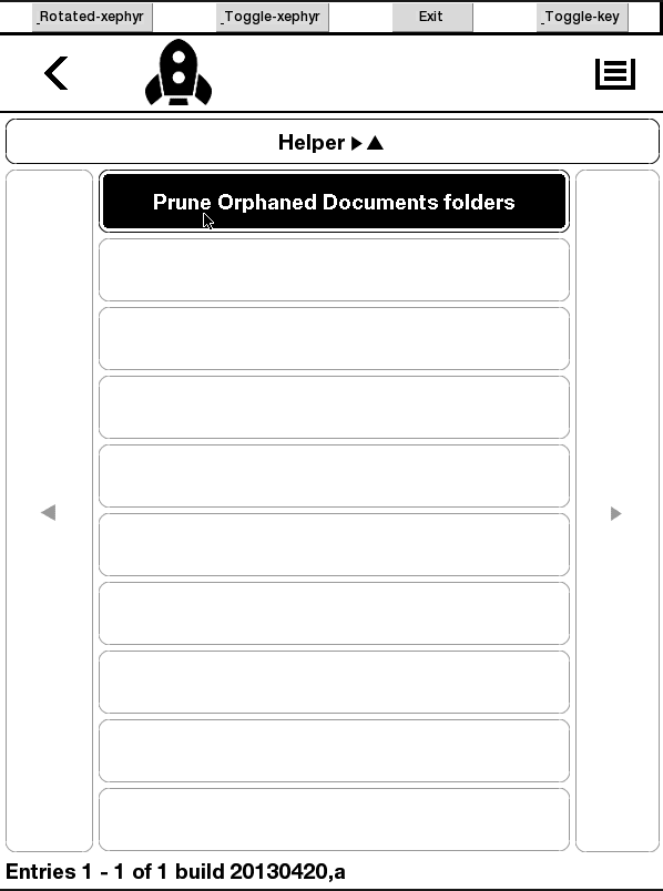

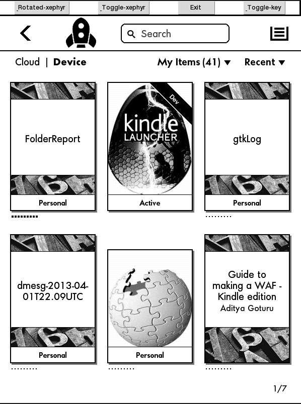

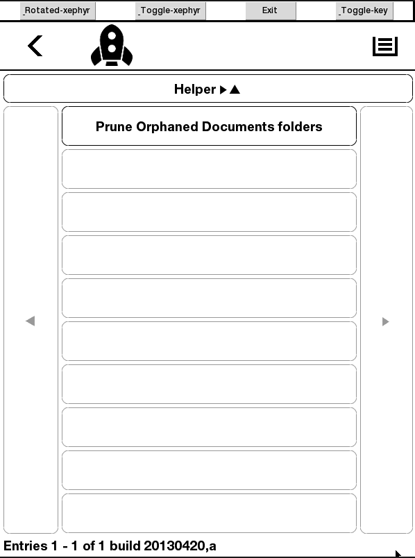

Originally Posted by hfpop View Post
After removing a book on Paperwhite, using the usual interface method (i.e. no USB or otherwise), the book-filename.sdr folder is still there, inside the documents folder. It will have to be removed manually. I find this very annoying.
Is there a solution to this problem? Maybe a script to clean documents folder, written for Kindle Launcher?

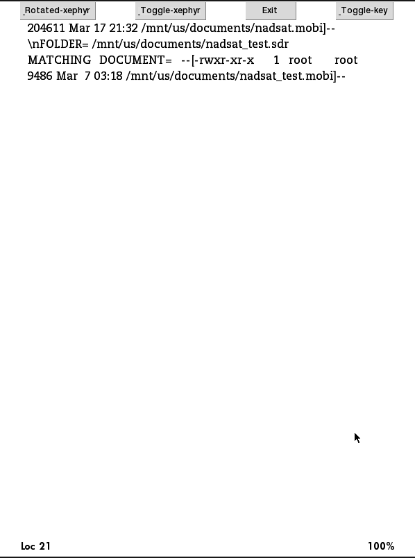

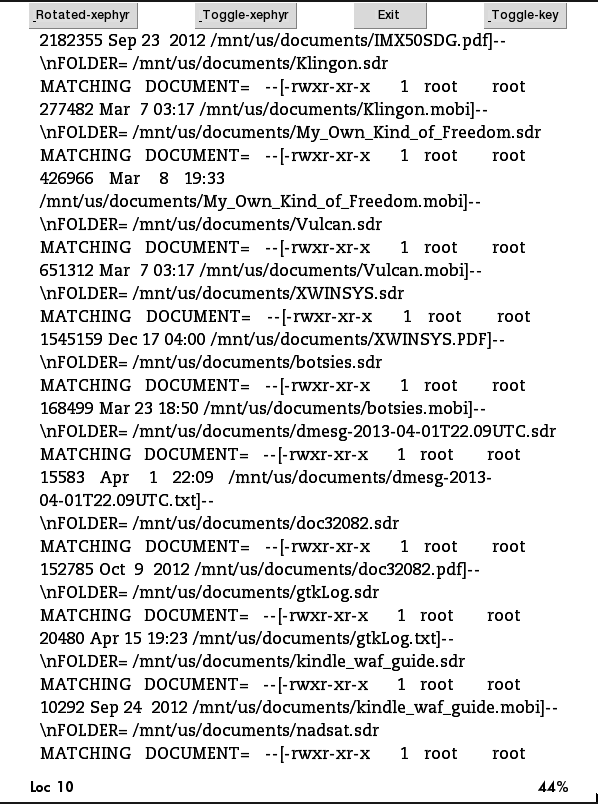

REPORT="/mnt/us/documents/FolderReport.txt"; rm -f $REPORT ; echo "new Report `date`" > $REPORT; IFS=$'\n'; for TEST in $(ls -d /mnt/us/documents/* | grep .sdr); do echo -ne "\r\rFOLDER= $TEST\r" >> $REPORT; TEST2=$(ls -Al "`dirname \"$TEST\"`""/""`echo "$TEST"| sed 's|.*\/\([^\.]*\)\(\..*\)$|\1|g'`".*"" | grep -v 'sdr' | grep "`dirname \"$TEST\"`" ) ; echo "MATCHING DOCUMENT= --[""$TEST2""]--" >> $REPORT; if [ -z "$TEST2" ]; then echo "DELETION CANDIDATE SELECTED $TEST" >> $REPORT ; rm -rf "$TEST" ;fi; done;
something like that
new Report Tue Apr 23 09:01:22 UTC 2013
FOLDER= /mnt/us/documents/3rd Sight_ A Horror Novel_123.sdr
MATCHING DOCUMENT= --[-rwxr-xr-x    1 root     root        399924 Mar  1 16:22 /mnt/us/documents/3rd Sight_ A Horror Novel_123.azw3]--
FOLDER= /mnt/us/documents/Ash_123.sdr
MATCHING DOCUMENT= --[-rwxr-xr-x    1 root     root        759140 Sep 20  2012 /mnt/us/documents/Ash_123.azw3]--
FOLDER= /mnt/us/documents/Battery-2013-02-28T17.50UTC.sdr
MATCHING DOCUMENT= --[]--
DELETION CANDIDATE SELECTED /mnt/us/documents/Battery-2013-02-28T17.50UTC.sdr
FOLDER= /mnt/us/documents/Chinese Chess Rules - Awak.sdr
MATCHING DOCUMENT= --[-rwxr-xr-x    1 root     root        383635 Feb 27 23:59 /mnt/us/documents/Chinese Chess Rules - Awak.azw3]--
FOLDER= /mnt/us/documents/Cloud Atlas_123.sdr
MATCHING DOCUMENT= --[-rwxr-xr-x    1 root     root       1371188 Apr  7 11:13 /mnt/us/documents/Cloud Atlas_123.azw3]--
FOLDER= /mnt/us/documents/Countdown_ H Hour_123.sdr
MATCHING DOCUMENT= --[-rwxr-xr-x    1 root     root        712620 Jan 11 06:47 /mnt/us/documents/Countdown_ H Hour_123.azw]--
FOLDER= /mnt/us/documents/Csound5.18_manual.sdr
MATCHING DOCUMENT= --[-rwxr-xr-x    1 root     root      11231282 Aug 28  2012 /mnt/us/documents/Csound5.18_manual.pdf]--
FOLDER= /mnt/us/documents/FolderReport.sdr
MATCHING DOCUMENT= --[-rwxr-xr-x    1 root     root          1366 Apr 23 01:15 /mnt/us/documents/FolderReport.txt]--
FOLDER= /mnt/us/documents/IMX50SDG.sdr
MATCHING DOCUMENT= --[-rwxr-xr-x    1 root     root       2182355 Sep 23  2012 /mnt/us/documents/IMX50SDG.pdf]--
FOLDER= /mnt/us/documents/Klingon.sdr
MATCHING DOCUMENT= --[-rwxr-xr-x    1 root     root        277482 Mar  7 03:17 /mnt/us/documents/Klingon.mobi]--
FOLDER= /mnt/us/documents/My Clippings.sdr
DELETION CANDIDATE SELECTED /mnt/us/documents/My Clippings.sdr
FOLDER= /mnt/us/documents/My_Own_Kind_of_Freedom.sdr
MATCHING DOCUMENT= --[-rwxr-xr-x    1 root     root        426966 Mar  8 19:33 /mnt/us/documents/My_Own_Kind_of_Freedom.mobi]--
FOLDER= /mnt/us/documents/Vulcan.sdr
MATCHING DOCUMENT= --[-rwxr-xr-x    1 root     root        651312 Mar  7 03:17 /mnt/us/documents/Vulcan.mobi]--
FOLDER= /mnt/us/documents/WAFs info.sdr
DELETION CANDIDATE SELECTED /mnt/us/documents/WAFs info.sdr
FOLDER= /mnt/us/documents/XWINSYS.sdr
MATCHING DOCUMENT= --[-rwxr-xr-x    1 root     root       1545159 Dec 17 04:00 /mnt/us/documents/XWINSYS.PDF]--
FOLDER= /mnt/us/documents/botsies.sdr
MATCHING DOCUMENT= --[-rwxr-xr-x    1 root     root        168499 Mar 23 18:50 /mnt/us/documents/botsies.mobi]--
FOLDER= /mnt/us/documents/dmesg-2013-04-01T22.09UTC.sdr
MATCHING DOCUMENT= --[-rwxr-xr-x    1 root     root         15583 Apr  1 22:09 /mnt/us/documents/dmesg-2013-04-01T22.09UTC.txt]--
FOLDER= /mnt/us/documents/doc32082.sdr
MATCHING DOCUMENT= --[-rwxr-xr-x    1 root     root        152785 Oct  9  2012 /mnt/us/documents/doc32082.pdf]--
FOLDER= /mnt/us/documents/dotsies.sdr
DELETION CANDIDATE SELECTED /mnt/us/documents/dotsies.sdr
FOLDER= /mnt/us/documents/gtkLog.sdr
MATCHING DOCUMENT= --[-rwxr-xr-x    1 root     root         20480 Apr 15 19:23 /mnt/us/documents/gtkLog.txt]--
FOLDER= /mnt/us/documents/kindle_waf_guide.sdr
MATCHING DOCUMENT= --[-rwxr-xr-x    1 root     root         10292 Sep 24  2012 /mnt/us/documents/kindle_waf_guide.mobi]--
FOLDER= /mnt/us/documents/nadsat.sdr
MATCHING DOCUMENT= --[-rwxr-xr-x    1 root     root        204611 Mar 17 21:32 /mnt/us/documents/nadsat.mobi]--
FOLDER= /mnt/us/documents/nadsat_test.sdr
MATCHING DOCUMENT= --[-rwxr-xr-x    1 root     root          9486 Mar  7 03:18 /mnt/us/documents/nadsat_test.mobi]--
EDITS:
v4 - Fixed typo in menu.json (twice)
v3 - made reports have internal timestamps and to correctly update "most recent" report when sorted by recency.
v2 - Added corrected line-spacing escapes to reports
v1 - Made it work
