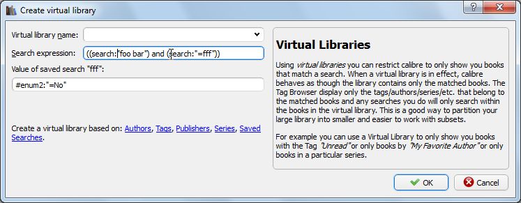

I found a way to track the mouse cursor in the text widget, and also realized that a quick-and-dirty parse would be sufficient. The result: what is shown in the dialog below.
If you hover the mouse pointer over the "s" of "search:", it will fill in the box below with the search expression. This is independent of the position of the editing cursor. That saved search expression will remain in the box until you hover over a different search. This lets you hover to get the search expression then copy and do whatever you want with it.
This stuff may not end up in the final release. When playing at this level we sometimes run into problems with gui artifacts on one system or another. Kovid checks for this when he reviews the code and builds the various versions. If it happens here, then the changes will be removed.

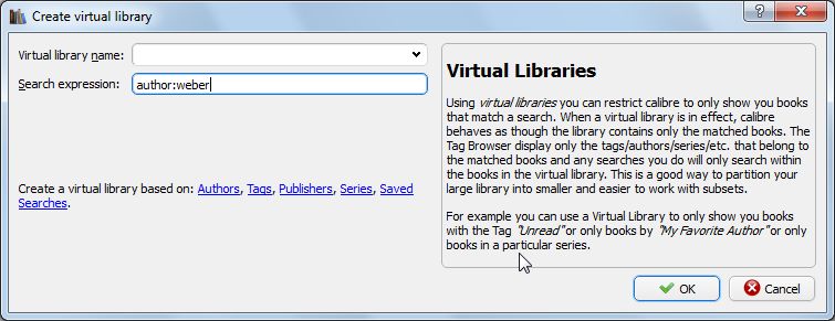

Kovid wanted me to do the display of saved searches differently.
The first image is what you see if there aren't any saved searches in the expression:
As you can see, it is not different from what it was before.

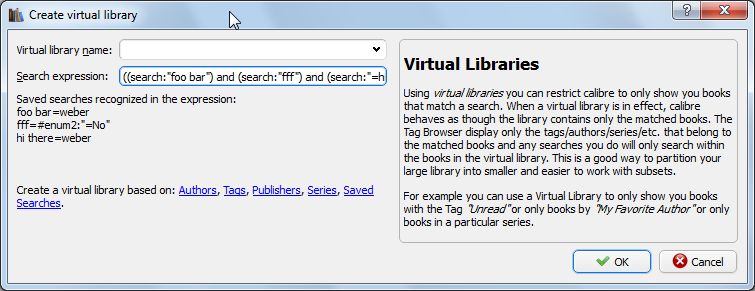

The next one is what you see if there are (recognizable) saved searches in the expression:
The saved search text can be selected with the mouse and copied to the clipboard. You would do this if you want to convert the saved search reference to the associated search expression.
This code is in trunk for those of you who run from source.
