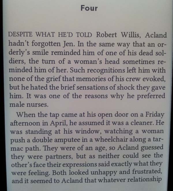

Edit: Seems like my gut-feel was correct this time. There is definitely more soft hyphenation visible on a Kobo with a standard epub (I don't know about kepubs) when this Hyphenation plugin is used. See attached pics - sorry for wonky camerawork
Left - Kobo displaying the original epub.
Right - Kobo displaying same epub (same font, same font-size, same margins) after using this plugin to add soft hyphens.
My conclusions: Plugin not really suitable for Sony PRSx50/PRS-T1 users but for Kobo users, who read in a language not well-supported by Kobo's own hyphenation dictionaries, this plugin should offer a workable alternative.
