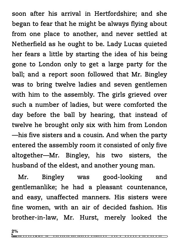

Kindles used to justify the entire line regardless of the amount of spacing needed between words. After a certain upgrade (available only for some Kindles), Amazon introduced an algorithm where no more than three spaces would be added between words.
If that wasn't enough to justify the line, then you would see a space at the end.
Jeff L is offline   Reply With Quote

Here, I've attached a screenshot to show how a converted epub (using Kindle Previewer) straight from PG looks. See how the line fifth from the bottom is weirdly stretchy. I was wondering whether that could be fixed by doing something to the epub's CSS.
