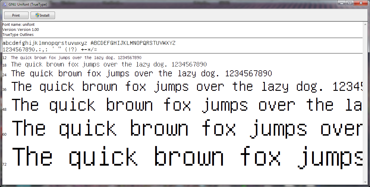

I love to use the Unifont font available here: http://unifoundry.com/unifont-5.1.20080907.zip (it's free as in freedom) it contains the whoel Unicode set! So you can read everything (Japanese, Italian, Chinese, Turkish, ... whatever) with only one font.
Simply create the usual fonts directory in Kobo root and put it inside... and it works!
I'm sorry but I can't see how anyone could recommend that font. It looks as if it was generated on a dot matrix printer. Code2000 covers pretty much the same glyph collection and is readable.
ID:	107341   Click image for larger version

It's actually ugly but it's free (meaning "libre" not "gratis") and (almost) full Unicode. 12pt size is just nice.
Code 2000 font is actually nicer but it's not compatible with free software licenses like GNU GPL or similar. Also the site seems dismissed... http://web.archive.org/web/201101081.../code2000.net/
