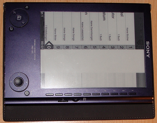

Hi folks,
today my loved prs-505 got damaged. And yes, it was my fault...somehow i dropped it to the ground
So now i'm facing the following problem:
The reader starts and acts as usually but the display is misplaced. It's moved to the left half of the screen. Or better said: Just the left half of the screen is used for display.
I tried resetting the reader (soft and hard reset) but it didn't help.
Because i'm living in germany i can't just go to the next sony shop. Sending the damaged reader to a friend who is living in USA would be expensive especially if there is no chance to get it repaired for a reasonable price.
So maybe someone of you can tell me from the attached pictures if the E-INK itself is damaged or if it's "only" a controller problem which sony could repair without much trouble.
Thank you in advance,
Michael

Does your 505 show signs of physical damage? it doesn't look like a broken screen. What you could do it email Sony and send them one of the photos and see what they have to say before sending it out.

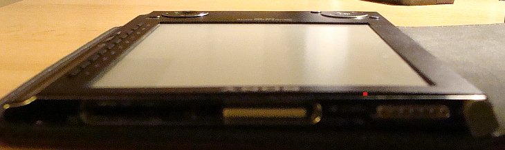

The display frame on the top is a little bit loose. Not really loose...i just can push it down 2-3 millimeters. I tried to make a photo but it's a little bit too small for my camera. The little red square in the attached photo (full size view) shows what i mean with "a little bit loose"...
Thank you for the advice. I will do so and see what sony will say to the pictures.
I never thought that i could miss a device so much as i do in the case of the reader...

When my display broke, it didn't display anything other than a random mosaic. The fact that this is still displaying an actual screen makes me think that it's something else that got borked. (Perhaps the ribbon cable?)
Sorry to hear that you broke your readers display. But on the other hand it doesn't sound that bad to me that my readers display seems just to use a negative left offset. I thought too that the cable might possibly not be connected right anymore. But at the moment i'm waiting for response by the sony support. I don't want disassamble the reader as long as i don't know what the sony people think about the problem.
Well, if sonys support is really that bad as i read it here in many posts, i will take a look inside the reader. But the hope dies last...

Unfortunately the main issue is a break in the screen substrate on the right side of the display (where it shows some strange horizontal lines). After getting informed about this i decided to buy a new one.
