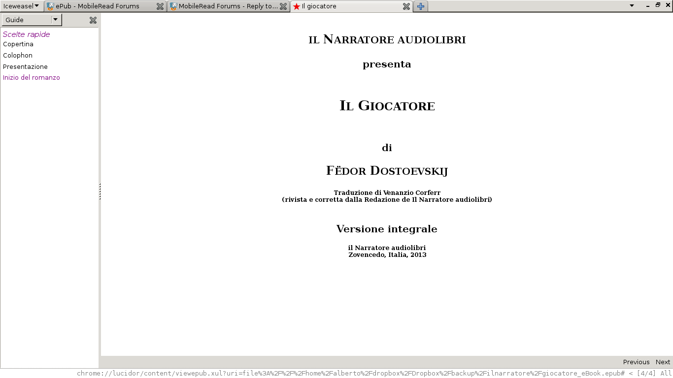

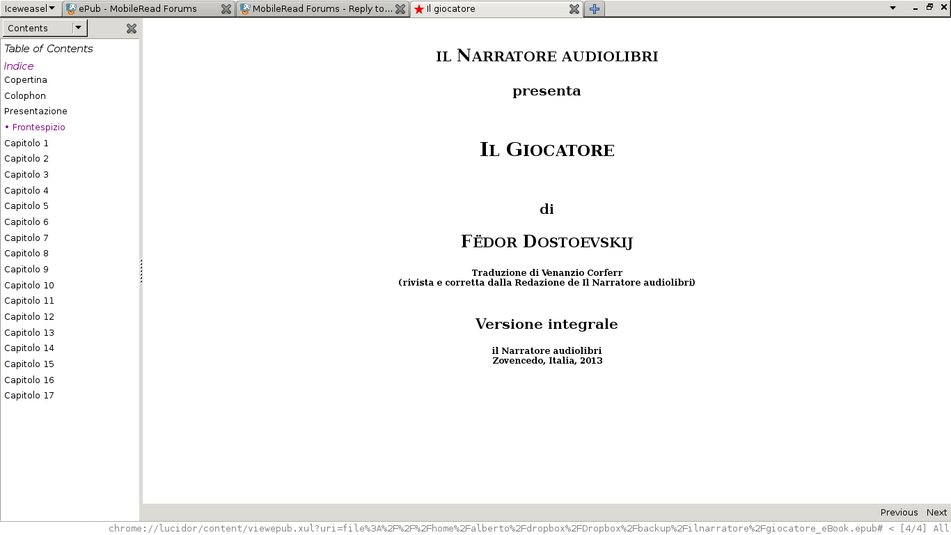

I don't know of any ePub reader actually using the guide.
Lucidor/Lucifox does use it, you can see the items in the guide instead of the items in the TOC, on the left panel of the app.
