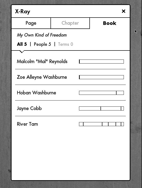

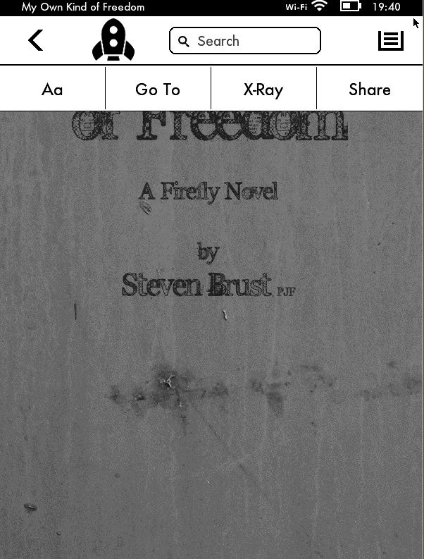

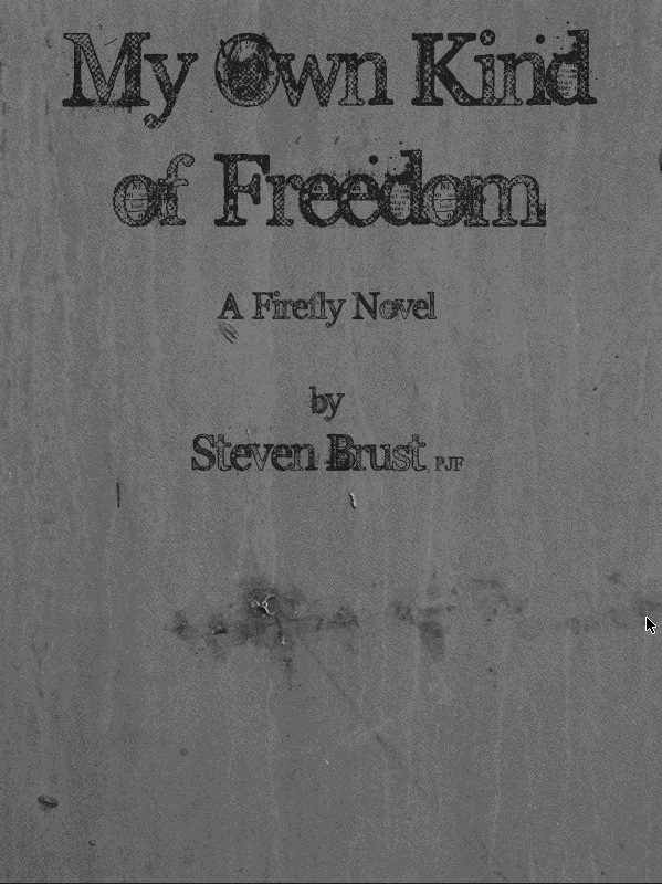

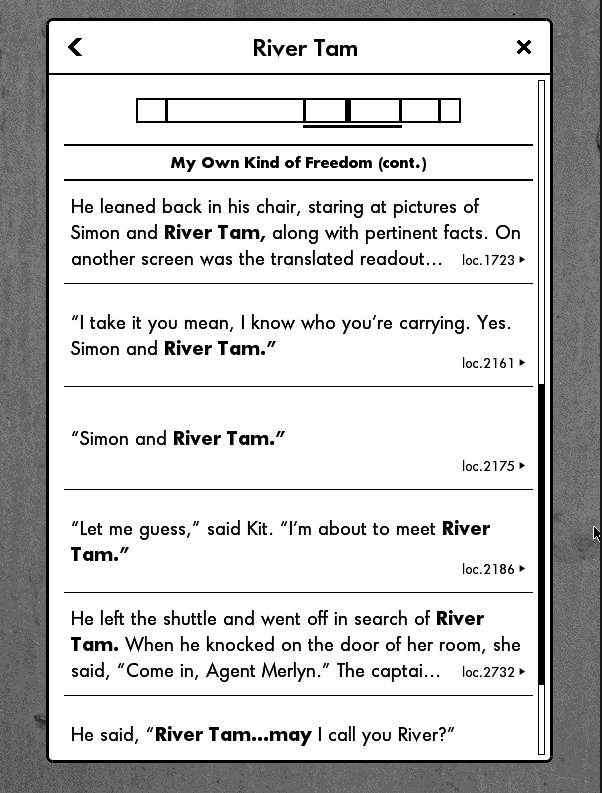

Tested as working great on windows btw.
obviously aliases are needed for this to be more helpful and more actual Xray content. but hey... It's a one man effort for the content so far...
With some love it could be awesome.
I love this mod. and the modders who made it.
And the book : D
