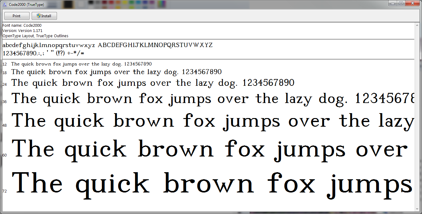

Old 06-25-2013, 03:17 PM   #40
Posts: 56,060
Karma: 182882152
Originally Posted by Geco View Post
I love to use the Unifont font available here: http://unifoundry.com/unifont-5.1.20080907.zip (it's free as in freedom) it contains the whoel Unicode set! So you can read everything (Japanese, Italian, Chinese, Turkish, ... whatever) with only one font.
Simply create the usual fonts directory in Kobo root and put it inside... and it works!
I'm sorry but I can't see how anyone could recommend that font. It looks as if it was generated on a dot matrix printer. Code2000 covers pretty much the same glyph collection and is readable.
ID:	107341   Click image for larger version
Old 06-26-2013, 03:54 AM   #41
ShellShock
ShellShock ought to be getting tired of karma fortunes by now.ShellShock ought to be getting tired of karma fortunes by now.ShellShock ought to be getting tired of karma fortunes by now.ShellShock ought to be getting tired of karma fortunes by now.ShellShock ought to be getting tired of karma fortunes by now.ShellShock ought to be getting tired of karma fortunes by now.ShellShock ought to be getting tired of karma fortunes by now.ShellShock ought to be getting tired of karma fortunes by now.ShellShock ought to be getting tired of karma fortunes by now.ShellShock ought to be getting tired of karma fortunes by now.ShellShock ought to be getting tired of karma fortunes by now.
ShellShock's Avatar
Posts: 1,185
Karma: 2431850
Join Date: Sep 2008
Device: IPad Mini 2 Retina
Re: Code2000, I agree this is much better looking than Unifont, but does Code2000 have bold and italic variants (could only see regular in the download)?
ShellShock is offline   Reply With Quote
Old 06-26-2013, 09:49 AM   #42
dmapr
dmapr ought to be getting tired of karma fortunes by now.dmapr ought to be getting tired of karma fortunes by now.dmapr ought to be getting tired of karma fortunes by now.dmapr ought to be getting tired of karma fortunes by now.dmapr ought to be getting tired of karma fortunes by now.dmapr ought to be getting tired of karma fortunes by now.dmapr ought to be getting tired of karma fortunes by now.dmapr ought to be getting tired of karma fortunes by now.dmapr ought to be getting tired of karma fortunes by now.dmapr ought to be getting tired of karma fortunes by now.dmapr ought to be getting tired of karma fortunes by now.
Posts: 469
Karma: 600816
Device: Kobo Aura HD, Kobo Aura One
Doesn't appear to be, I googled quite extensively.
dmapr is offline   Reply With Quote
Old 06-26-2013, 12:14 PM   #43
Posts: 56,060
Karma: 182882152
As far as I know, it only has the normal variant. I only use it for testing with languages that are not supported by my usual font choices so have not made use of any variants.
Regards,
David
