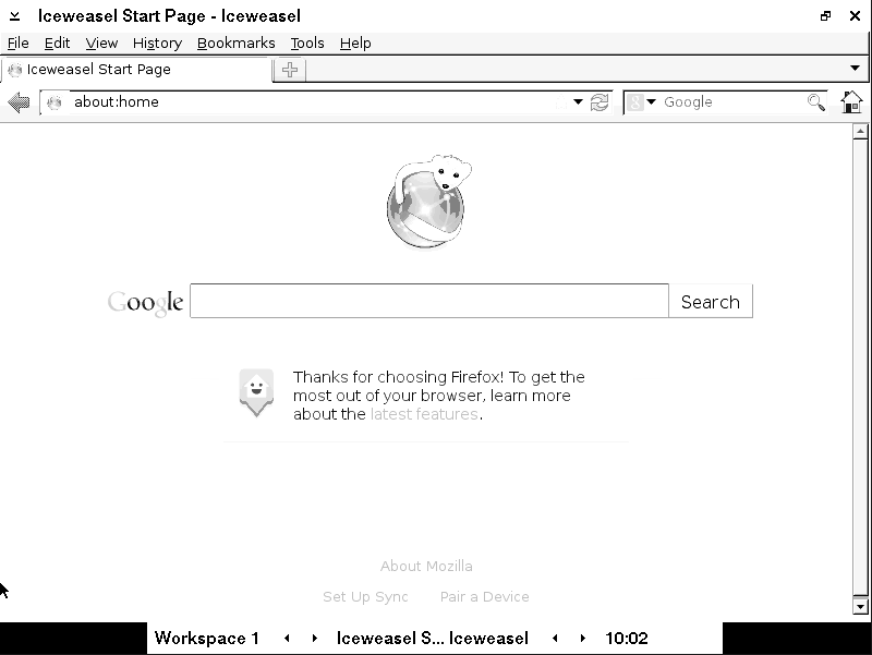

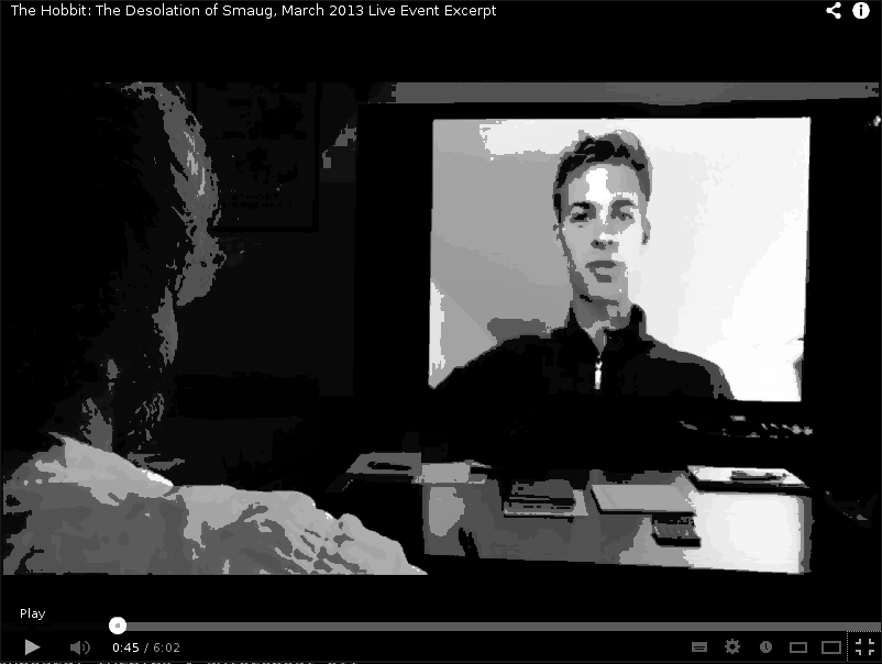

I would really like this to support a web proxy.
Have to research that I suppose
I also would appreciate a tip or two on:
me@dev /usr/local/src/skipstone-1.0.1 $ CC=/opt/arm-2007q3/bin/arm-none-linux-gnueabi-gcc ./configure --prefix=/mnt/us/extensions/skipstone/ --build=i686-pc-linux-gnu --host=arm-none-linux-gnueabi
configure: error: Cannot find mozilla includes - please use --with-mozilla-includes=path_to_mozilla_includes and specify a path
Guess I need to do some more reading on that too...
In the meantime I'll play with iceweasel then.
EDIT: Youtube working was a nice surprise on iceweasel... html5 to the rescue I guess. Yet ANOTHER reason to get 1 bit dither working in Xephyr then... maybe if I find enough reasons someone will one day help ;P
