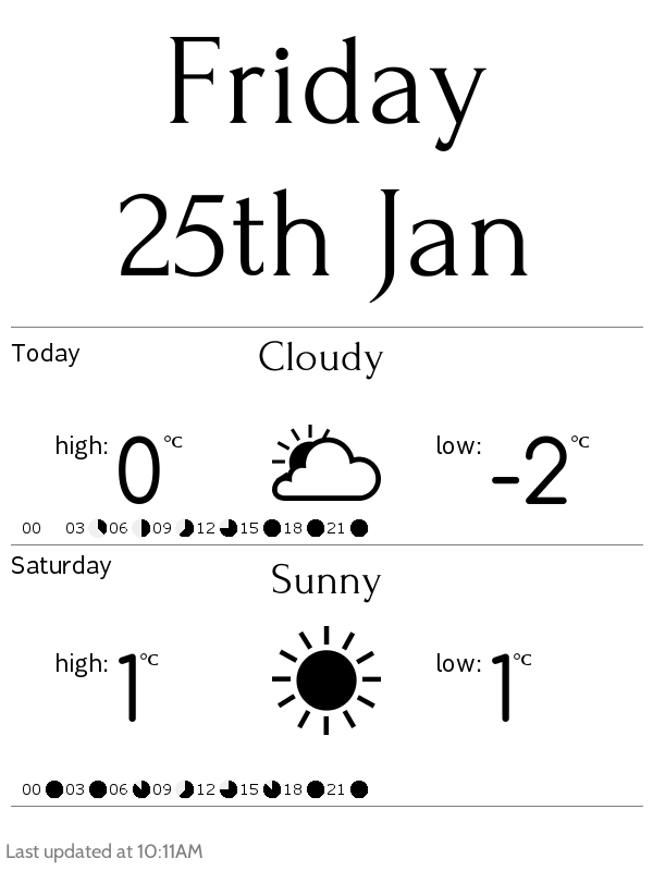

My version
Here's a screenshot (on Windows) of my first attempt. It's based mainly on Kevin's original version but with only two days' weather forecast as I wanted a big date display. I'm also pulling in cloud cover forecast information from 7timer (http://www.7timer.com/index.php?product=astro) as I'm an amateur astronomer.
Andrew
andyh2000 is offline   Reply With Quote
