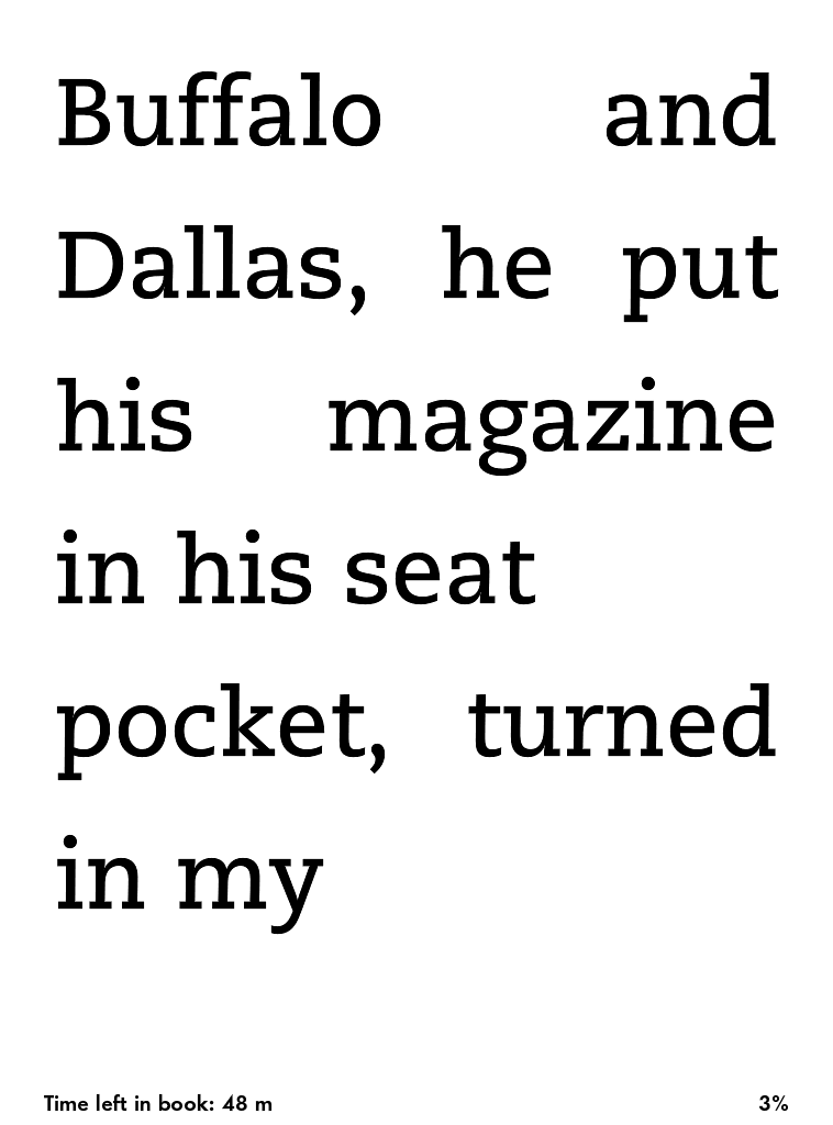

I recently bought some books from Amazon where I could not change the fonts.
It's blocked on some ugly slab-serif semi-egyptienne font, and even though the 'Aa' menu comes up, and I could select a different font, it has no effect on the actual displayed font.
I spent half an hour in chat with Amazon, and in the end they said that they'd 'send the request to the tech guys'. In the end it was child's-play to remove the DRM (Thanks Apprentice-Alf) and convert it back to mobi, without all the limitations.
Out of curiosity I had a look at the 'exploded' contents of the book and found a CSS that specifies 'Times New Roman' just about everywhere. But the font I see is definitely NOT Times New Roman. It looks like the attachment.
What is that font? And why does it propose that?
(I tried Identifont.com, but couldn't find anything that looked close enough.)
I also just bought another book, and it has exactly the same problem. Is there a faster way to communicate one's displeasure, than spending half an hour in the Amazon chat? (I'm in Switzerland, and they apparently can't phone me here. And I'd much prefer to solve it by email.)

Kindle falls back to Caecilia Regular if a book requests Times New Roman and you don't have it installed. From your picture it could be Caecilia, hard to tell.
Edit: Yes, that is definately Caecilia - was judging from thumbnail alone. The blowup shows it clearly.

No, even changing the default on a jailbroke is not trivial. Requires best to my knowledge a deep reconfiguration of fontconfig. Hiding fonts that you don't intend to use is rather simple in comparison. The easiest to change the fall back for Times New Roman would appear to just install a font with that name (have not tested that though).
What I can tell from reading the config files is this:
  • all common fonts (post-script, microsoft, ...) get grouped together that fonts that are similar are considered the same, with one font beeing the fall back
  • each of those groups get classified a generic like serif, san-serif or monospace (san-serif is beeing used when everything else fails)
  • those generics are then assigned a priority list of which fonts to use in case such a generic is to be used
So for the case of Times New Roman it goes something like this (in that order pretty much and on Paperwhite):
  • Times New Roman gets grouped together with other fonts/groups:
    Times New Roman (fallback)
    Liberation Serif
    Thorndale
    Thorndale AMT
  • Times New Roman(MS) and Times(PS) get assigned fallback for each other
  • Times New Roman gets assigned the generic classification of serif among other fonts (Bitstream Vera Serif, DejaVu Serif, Liberation Serif, Times New Roman, Times, Nimbus Roman No9 L, Luxi Serif, Thorndale AMT, Thorndale)
  • actually installed fonts on the PW get added to serif (Palatino, Baskerville, condensed, Caecilia Regular, Kindle Symbol, TBMincho, HYMyeongJo, Song S, Song T, Code2000)
  • serif gets this priority list:
    Caecilia Regular
    Kindle Symbol
    TBMincho
    HYMyeongJo
    Song S
    Song T
    Code2000
Now if a book requests Times New Roman it will rattle through the list top to bottom until it finds a match of a font that is installed. Remember that by the time it falls back to Caecilia, the name Caecila Regular itself is not a single font any more, but a group.
