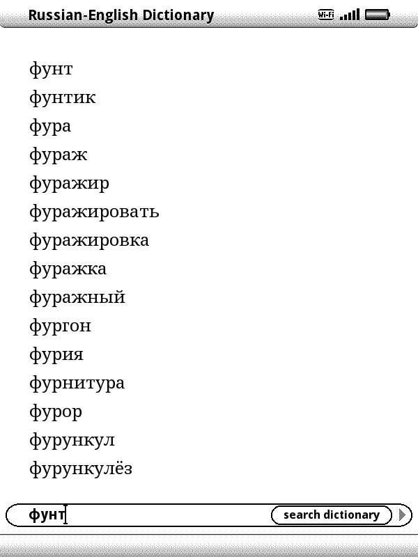

Opening the dictionary itself and searching for фунт shows the *index* of the dictionary:
Name:	index of dictionary.gif
and фунтов is not displayed.
