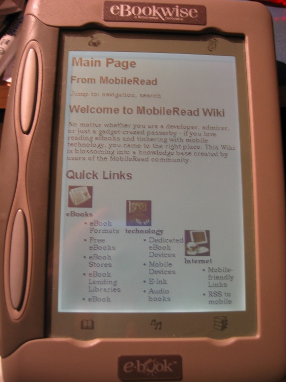

Thumbs up HOW-TO: Surf the Internet with the EBW1150 or REB1200
EDIT: To easily surf the internet WITHOUT using the (limited) Linreb or Privoxy, please use Impserve and be sure to download all of the Impserve plugins to allow the downloading of content directly from the internet to your ebook reader!!!
Over in the thread Hacking EBW-1150 to browse the Internet, we have been exploring and have now found an easy way to allow all ETI hardware readers to 'surf the internet'.
We being nrapallo (myself), Ret and, in absentia, Nandagopal Kirubanandan. Major thanks go out to Ret for originally having this idea and finally getting it to work AGAIN as well as to the original author of Linreb (Nandagopal Kirubanandan) wherever and whoever you are!!
OK, so you have this new/slightly used EBW1150 or this REB1200 lying at the bottom of your gadgets drawer and you think (well maybe with some help from me) can I get this thing to browse the internet? The answer would be YES!
Most with just a EBW1150 should follow the first and third HOW-TO below, whereas those with multiple ETI devices should follow the second and third HOW-TO below (follow?):
HOW-TO: Get just the EBW1150 to "Surf the Internet"
So, basically you need to do this:
1. Run Linreb (usually uses port 9090)
2. Run privoxy (usually uses port 8118)
3. In privoxy, add the line "forward .ebooksystem.net 127.0.0.1:9090"
(without the quotes) in Edit Main Configuration (config.txt in section 5.2)
4. Set the reader to use HTTP proxy pointing to the localhost IP address (127.0.0.1) and port of privoxy (usually uses port 8118).
Since privoxy, Linreb and the reader are connected to the same PC we just use 127.0.0.1.

EDIT: I took some more pictures of surfing the internet (better lighting and quality). Have a look at my REB1200 Album and EBW1150 Album!
As always, enjoy!

Name:	EBW1150-surfing-Mobileread Wiki Page1.JPG
ID:	15667   Click image for larger version
Name:	REB1200-surfing-Mobileread Wiki Page2.JPG
Last edited by nrapallo; 02-22-2009 at 11:58 PM. Reason: added pictures showing the surfing on the readers
