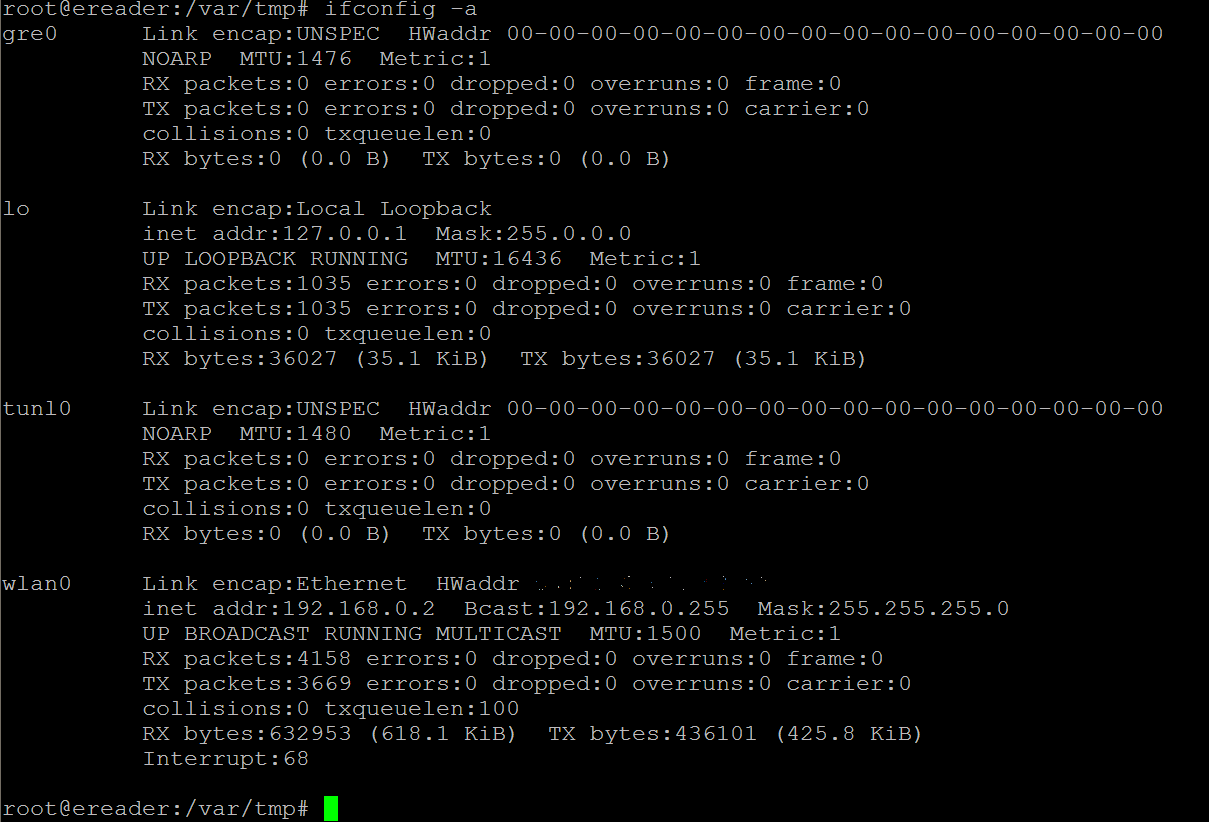

Originally Posted by karioka View Post
Someone got an idea or a zImage even compiled with driver TUN/TAP enable (IP Tunneling and GRE) ??
Hi karioka,
In the tarball you may find tun, ip_gre and ipip kernel modules (.o). Insmod them (e.g. "insmod ipip.o") and verify they get actually loaded ("lsmod").
Let us know your progresses, I might be interested to setup a vpn as well.
/Michele/
