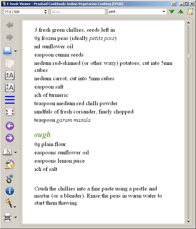

I would like to use my iBook reader for a Mobi book. However when I use calibre conversion, the initial lines of some sections are getting truncated. It is an Indian cook book and it appears to only affect sections with recipe information.
I am attaching a couple of screen captures to illustrate what I mean.
I would appreciate any guidance - anyone has to offer.
Thanks - Joe
I would guess you have created negative indents
Or your Font has damage to letters (parameters) that is not being ignored

Disable the Remove fake margins option under Look & Feel in the conversion dialog.

Your guidance worked perfectly. Thank you very much for Calibre and your help!!
