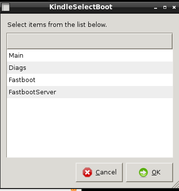

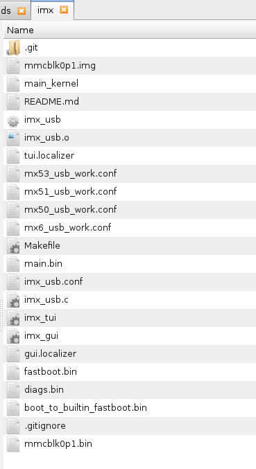

Some notes... Device K4
Files: http://ge.tt/8bd9NXU/v/1 & http://ge.tt/8bd9NXU/v/0
Resources: https://github.com/aditya3098/imx_usb_loader
Simple linux fastboot installing command:
https://www.mobileread.com/forums/sho...80&postcount=1
Get files
Install fastboot if we need to ON THE PC
sudo wget http://www.sudoforlunch.org/fastboot -O /usr/bin/fastboot && sudo chmod -cvR a+x /usr/bin/fastboot
(also you can read for reference: https://www.mobileread.com/forums/sho...&postcount=225)
Device K4 Silver:
Do Magic Key reboot. Pwr + Dwn
(choose fastboot ON THE PC)
sudo ./imx_gui
do the kernel remotely while we have the connetion ON THE PC
me@dev ~/GIT/imx $ sudo fastboot flash kernel /home/me/K4IMAGES/main_kernel
downloading 'kernel'...
OKAY [ 0.150s]
writing 'kernel'...
OKAY [ 0.603s]
finished. total time: 0.753s
reboot to diags to do the main image: ON THE PC
me@dev ~/GIT/imx $ sudo fastboot setvar bootmode diags
setting 'bootmode' to 'diags'...
bootmode diags:
finished. total time: 0.150s
ON THE PC
me@dev ~/GIT/imx $ sudo fastboot reboot
rebooting...
In the Kindle Diags screen:
Enable Usb Network:
N misc
U Utilities
Z usbnet
X continue
Left <
Hookup your machine in whatever way your OS needs.
For me an ifconfig of the usb port would do it. Then selecting that as the main network before I try to ssh...or scp... Some fiddling with host files may be required. it's not that tough to get past this section whatever your OS but is a popular stumbling place.
Put our files on if we didn't already...: ON THE PC
scp ./mmcblk0p1.img root@ktdb:/mnt/us/
root@ktdb's password:
mmcblk0p1.img 100% 350MB 1.9MB/s 03:05
(you could export ktdb=192.168.15.244 or use a hosts file, or refer by IP, etc...)
ON THE PC
me@dev ~/GIT/imx $ ssh root@192.168.15.244 \
dd if=/mnt/us/mmcblk0p1.img \
of=/dev/mmcblk0p1 bs=1024
358400+0 records in
358400+0 records out
367001600 bytes (350.0MB) copied, 305.112103 seconds, 1.1MB/s
Reboot, exit Diags with export to xml if you want to be extra thorough, or just set the mode or whatever to main.
K4 debrick. chalk it up.
