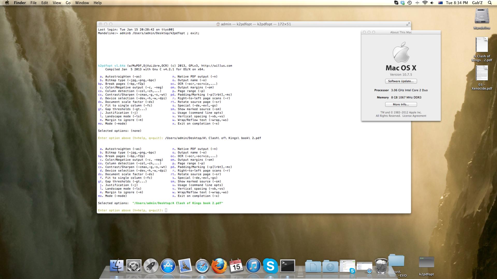

Can't get K2pdfopt to convert
Hi there, I can't get k2pdfopt to convert on my mac.
I've attached a screenshot of it.
Am I doing something wrong?
Cheers
Thank you for the screen shot. That's a big help. It looks like you've done everything you need to do except press <Enter> to start the conversion. Did you do that?

Ah! So I had to press <Enter> again! It works great now!
Thanks for the update to the help page as well!
