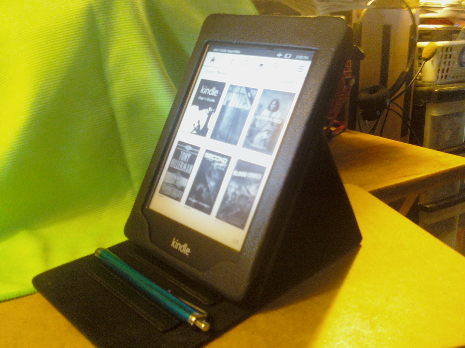

Nope, I don't much like that design. Here's mine ($12.99 and free shipping):
Name:	My PaperWhite.jpg
And it has a handy spot at the lower right corner to put the magnet anyway (and it'll be hidden).
Well you did a mighty fine job of research!
