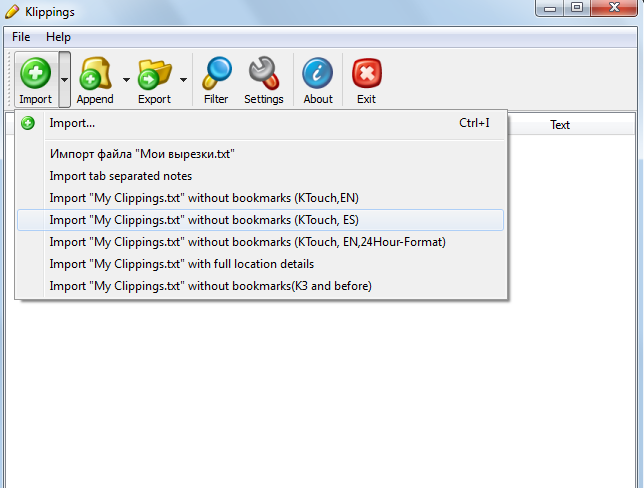

Name:	Untitled picture.png
Alternatively, you can modify the current one also. just add this into the appropriate line( anywhere between 5-40 w/o breaking the current structure.)

I also tried it : Click image for larger version
Are you sure that you are using this import option to import your MyClippings.txt?:
Import> "Import "My Clippings.txt" without bookmarks (KTouch, ES)"
thomass is offline   Reply With Quote
Old 06-16-2012, 11:36 PM   #8
marianormr
marianormr began at the beginning.
Posts: 4
Join Date: Jun 2012
Device: Kindle Touch
thank you very much
you are my hero
genius
