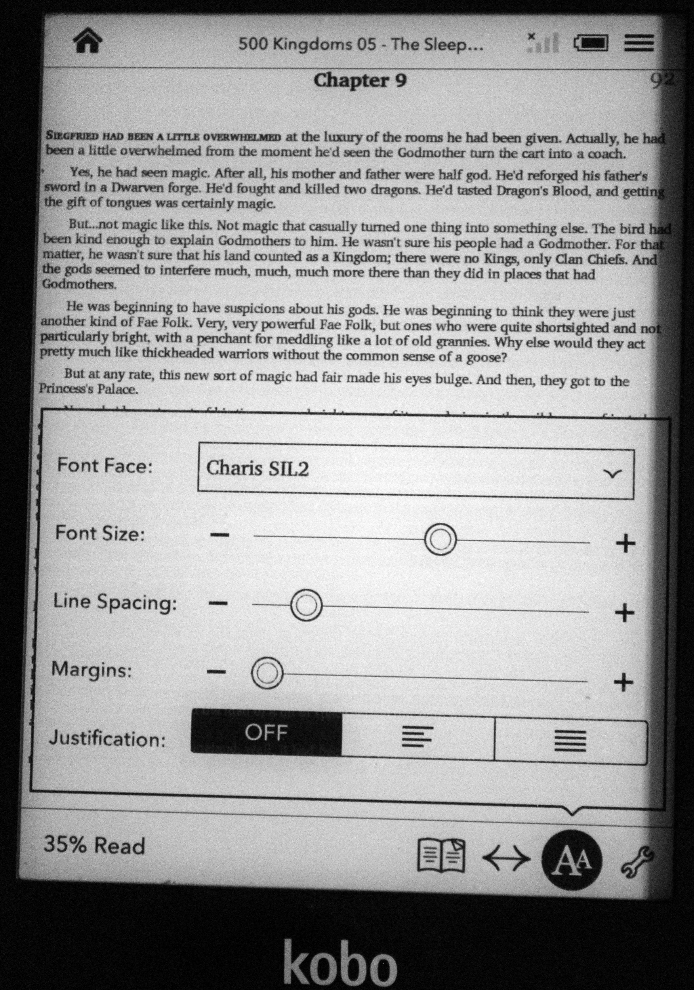

I don't have either book (I do have "A Civil Campaign" in paperback), so David Weber's "On Basilisk Station" sounds like a good test (but I really have to read it someday). I have my Touch and Glo sitting next to each other, one upside down, and just tapping the screen like you are. I haven't gotten all the way through yet, but haven't had the problem.
What did occur to me is that I use a smallish font size. So, I upped it by two steps on each device. And it could be font related. I user Georgia, size is 17 on the Touch and 23 on the Glo and the margins and line spacing are at the minimum. I could see the font and size affecting this. What are you using?
I've used Century Schoolbook, Charis SIL and Georgia (two added fonts, one built in) and it has happened with all three. Line spacing and margins are set to their minimums. Font size on the Glo is 28. I could kidnap the Touch back from my daughter so I could be more exact but will settle for saying she uses a font size about 3 steps smaller than I would use.
I went through "On Basilisk Station" at least twice on both devices. For one pass on the Glo, I changed to Caecillia and the size is probably about 28.
Why do I have the feeling that if you tried to get the Touch from your daughter, that you would come out of it worse?
She is probably using 16 or 17 on the Touch. That looks about the same as 23 or 24 on the Glo.
This and the reopening position are bugging me. It feels like we are running different versions. There is a slight possibility the firmware didn't apply properly. Doing a manual install over the current firmware for a device that isn't working might be an idea. That would be safe and can always be fixed with a factory reset.

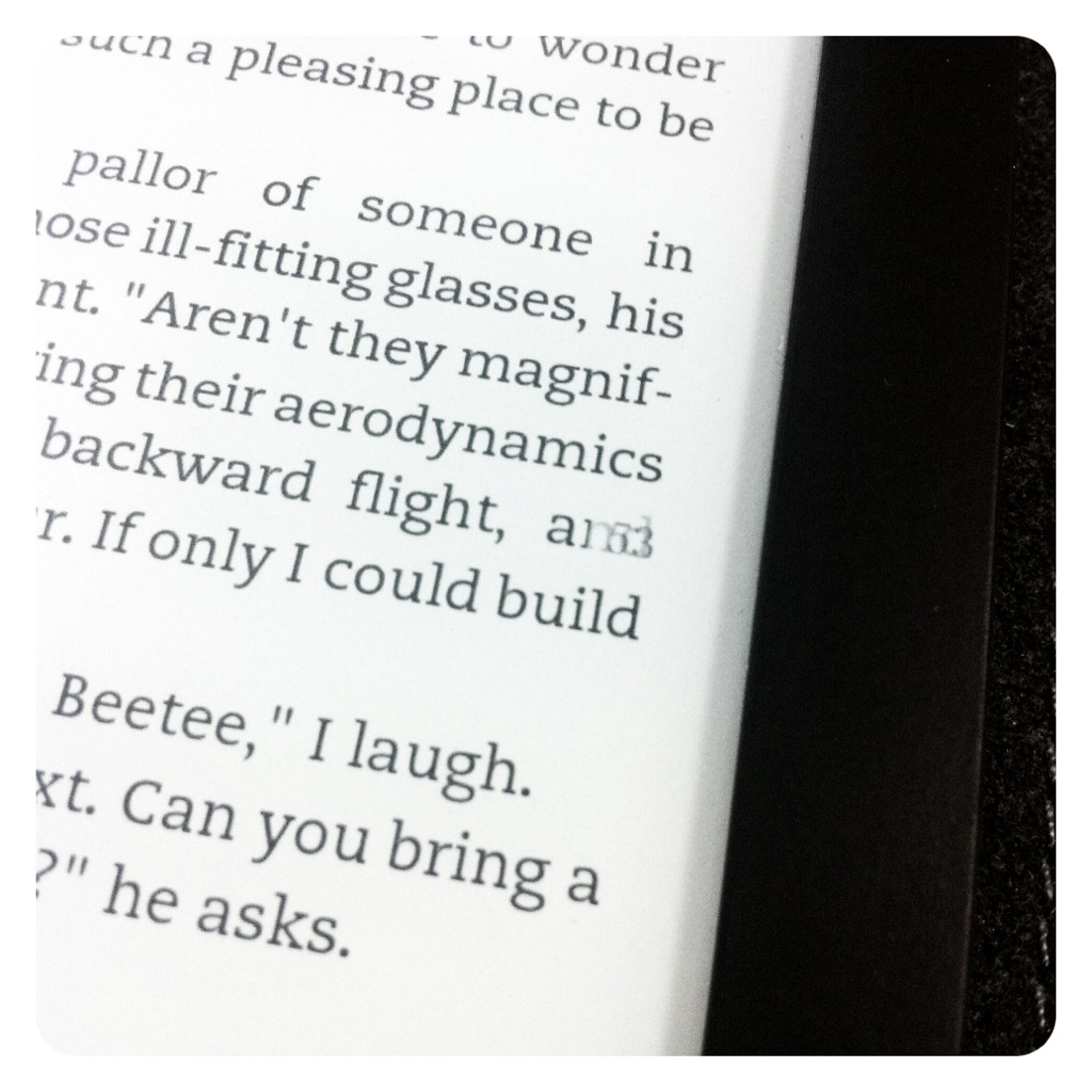

That's why I guestimated the font size. Colour me yellow. Anyhow, moving on to re-reading the 500 Kingdoms series and took a couple of photos of the screen when the glitch happened. Hopefully, I can attach them here though taking pictures by the light of a fluorescent lamp doesn't give the greatest results.
So far, I've found changing font or font size triggers the return to the correct font size.
