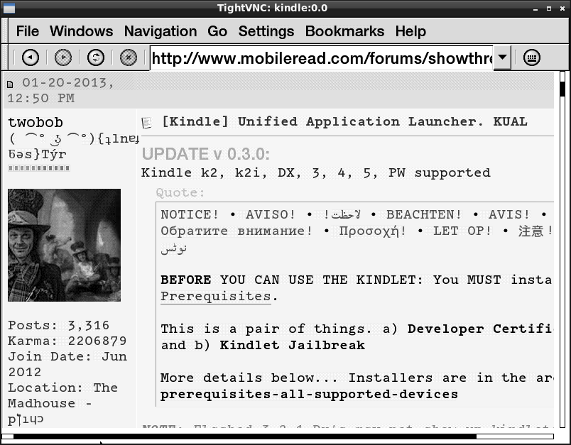

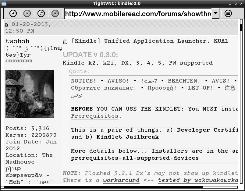

[root@kindle bin]# ./skipstone --help
Usage: skipstone -f http://www.someurl.com http://www.someurl2.com, ...
use --fullscreen or -f for fullscreen mode at startup
--help, this text
so...
Picture (1)
[root@kindle bin]# ./skipstone -f https://www.mobileread.com/forums/showthread.p
hp?p=2389078
Picture (2)
[root@kindle bin]# ./skipstone https://www.mobileread.com/forums/showthread.php?
p=2389078
Perhaps with a bit more love you could convince that address bar to be gone too...
Hope that helps. (sorry for the delay, been swamped)

Thanks for your example twobob! Now I got it working also. (For some weird reason I had used the wrong parameter -r instead of -f)
I got rid of the adressbar by switching it of from the settings menu before launching in fullscreen.
