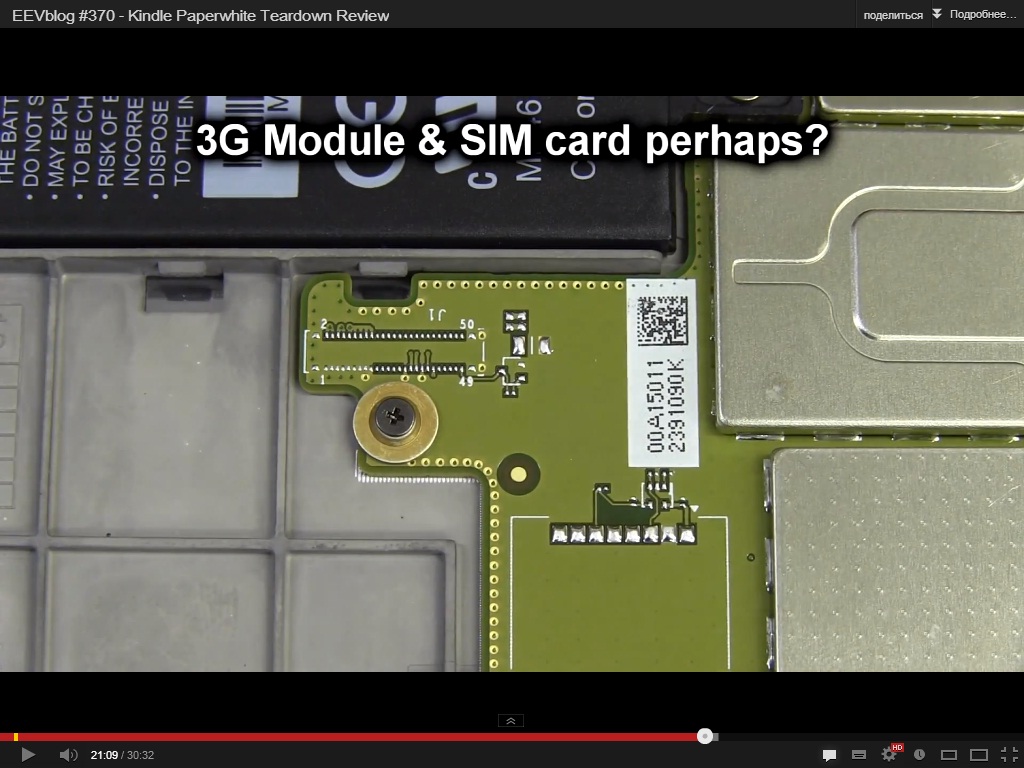

In Paperwhite other pinout! Disassemble it more difficult.
