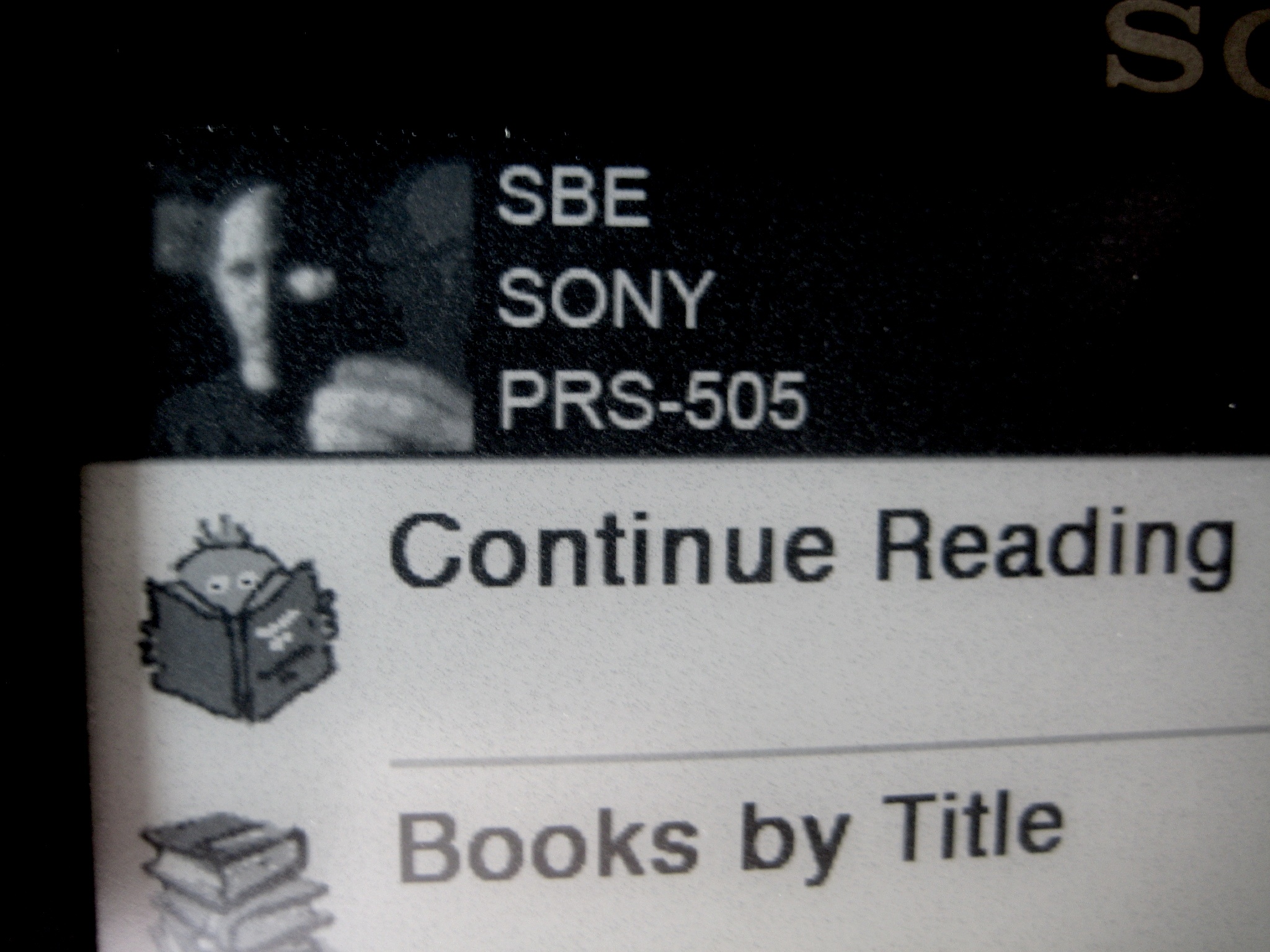

Posts: 98
Device: sony prs 505
here's my screen customized with a photo.
